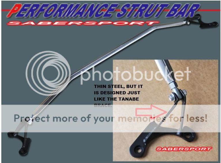

    I was looking at pictures of the Tanabe Strut tower brace, and realized that the tanabe is the same shape as the cheap ebay one. same 2 bolt on points, same thin welds from the cross member to the strut towers... I just may waste $45 with free shipping to find out!

    The bar in the Tanabe fastens directly to the 2-bolt tower plate. While the Tanabe bar is far from an ideal strut bar, it is much better than the $45 eBay bar. The obvious difference is that the 2-bolt pattern in the $45 brace is way out of the plane of the bar so the skinny legs connecting it to the plate in are loaded bending and they are flimsy.
    The flat plates on the Tanabe are sized and positioned as though Tanabe actually has clue what is going on there. They is positioned to provide high rigidity given the general design.
    On the $45 bar, it looks like they intended to make have thin plates bend.

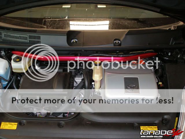

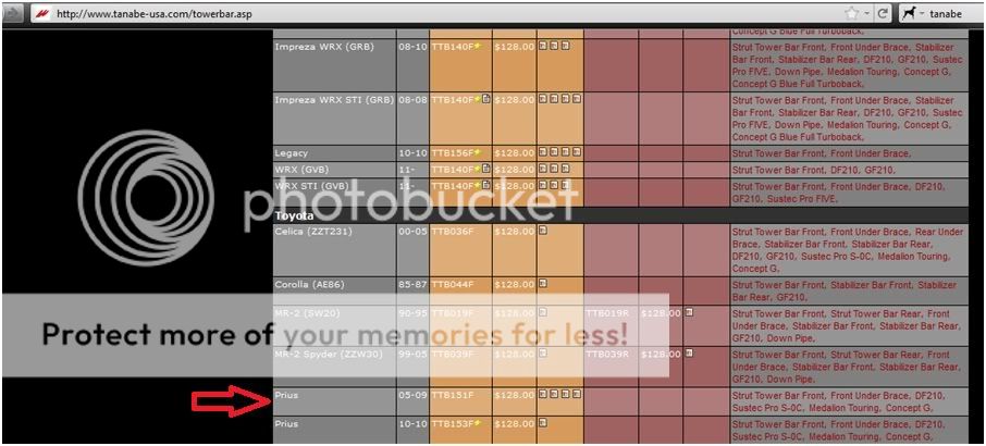

    [​IMG][​IMG][​IMG][​IMG][​IMG][​IMG] It appears to be a copy of the Tanabe brace, $140 for the Tanabe name, or $45 for the copy hmmm...
