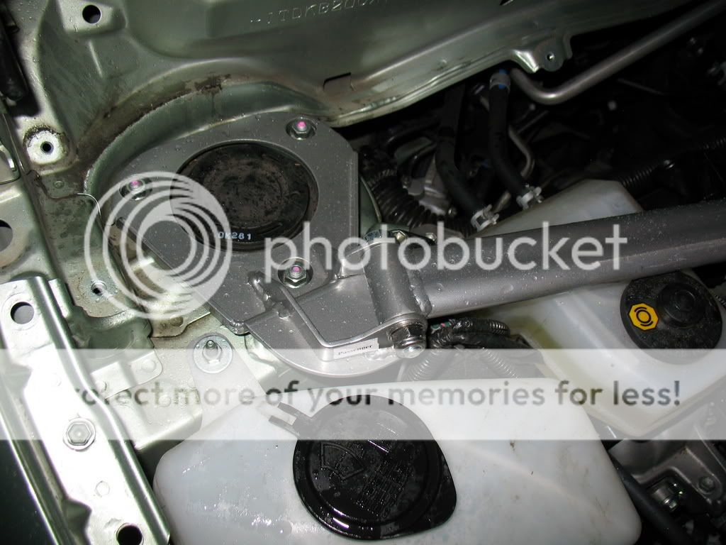

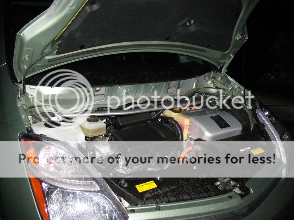

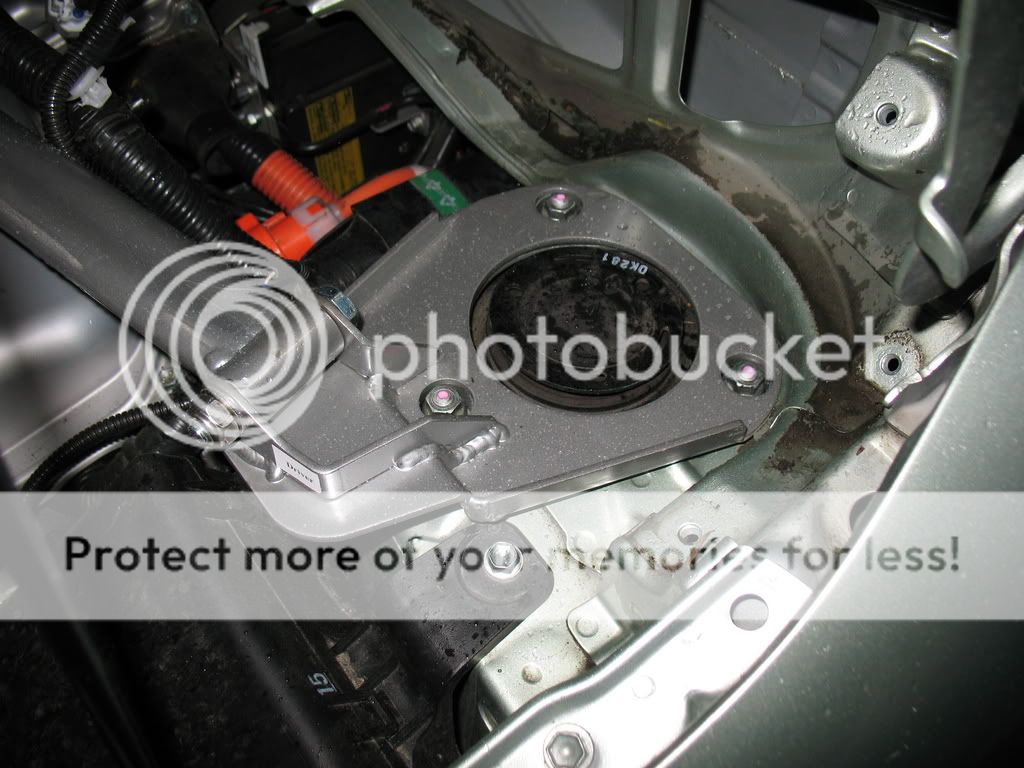

    I've noticed on e-Bay that there are three different low cost braces now - the two mentioned before that look very similar for under $50 and now one for $99 + S+H - eBay - New & used electronics, cars, apparel, collectibles, sporting goods & more at low prices
    The $99 one seems to be much improved as far as reinforcement at the towers in comparison to the lower priced ones (see pictures).
    [​IMG][​IMG][​IMG]
    These pictures were taken from the e-Bay auction page.
    Has anyone tried this brace?

    That strut bar looks much better constructed, it's almost like a clone of the BT-Strut brace. If anyone tries it please let us know how it performs!

    My next upgrade will likely be springs and shocks in ~20k mi which will likely be 10-20x as expensive. $45 buys a noticable tightness upgrade and a bit of protection if you own your car (in terms of distribution of shock tower forces). If I was buying a new bar today I would get the $99 bar just because it looks even better -- I'm not sure its worth upgrading my current shock tower brace though.

    I used those instructions and searched for Prius strut tower brace. It seems like there are two different no name type bars sold by different channels. The $45 shipped variant and the 99+ shipping variant which appears to be a worthy upgrade in construction.

    I just got the $99 bar today. It's installed big difference on the rode at 60 then
    rock the wheel it sways but recovers quickley. It corners nice. The bar says top
    but I tried that, bar lays flat on two caps, so turned it over clears every thing.
    You have to either grind or file the plastic are it won't clear the knuckles.
    It goes a lot faster if you loosen the nuts with socket then use a nut driver
    to take the nuts off. You will need 10 & 12 mm nut drive.

    I just brought the 99 from ebay!
    Fixed all well and can adjust the height of the bar.
    I had adjusted that the cap can be easily be removed.
    No affect on handling.
    Cheap and Good!
