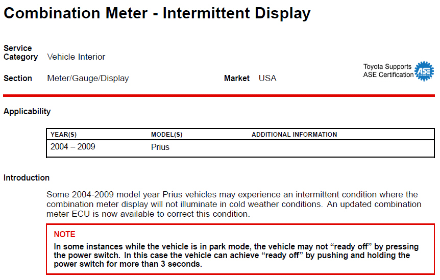

    You may have a bad display module. Power button is part of the problem, Toyota has extended the warranty on this part. Especially if the problem is repeatable. I carry my 2008 Prius notification in the glove box, you probably got one also but may not have paid attention. Nevertheless, the dealer can look it up.
    Update: The TSB 0172-09 is attached. Here's a link to a Combination Meter thread.

    I agree with rjparker, although the part in question, subject of the warantee extension, is more properly called the "Combination Meter", and the thing fails in all sorts of ways. Not turning off is one of them.

    I have a 2004 prius and does the same problem. I read about combination meter. And I go to ebay, to repair it. It cost about 150 dollar. I replace and solve the problem.
