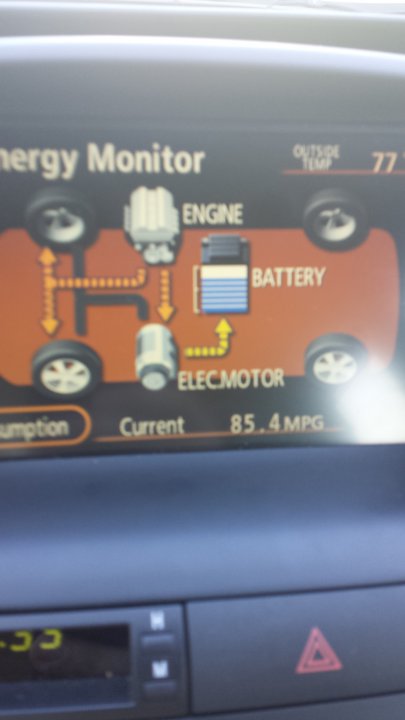

    I just got my first prius (2008) and I love it! I have also learned of a shop that does the Enginer plug in conversions. Has anyone done this? And if so, how do you like it? Thanks for the input.

    The photo is me driving at 56 mph on a warm florida morning :)
