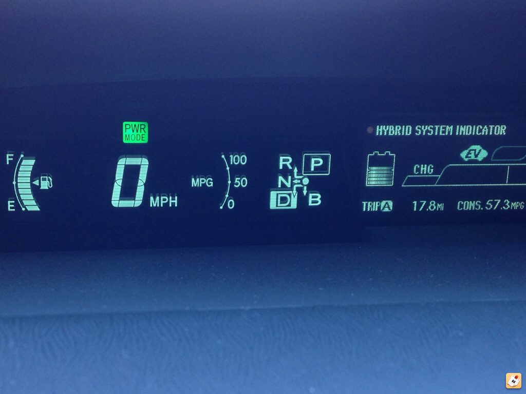

  16. 49erfaithful
    49erfaithful Junior Member
    Aug 13, 2013
    Bay Area, CA
    Are you pumping to the first click? Here's what mine looks like after pumping to just one click. Two clicks give me about 30 miles.
    Very strange how much it differs from the 2013 Prius Two rentals I've tested with this year.

  17. Jonny Zero
    Jonny Zero Giggidy
    Jun 22, 2012
    1,388
    351
    Austin, TX
    Yep, first click only. The floats in the tanks probably have a big variance in how they are calibrated.

  19. 49erfaithful
    Aug 13, 2013
    Bay Area, CA
    Hi all!
    Just a quick update.. Had my 5k service recently and brought the first PIP observation up to them. The dealer said that was definitely out of the ordinary, even in a five. They didn't find any "codes" that would indicate any issues, but 'reset' the system (not exactly sure what they reset). Anyways, now I'm having the first PIP disappear at 10-11 miles without fail. I might bring it back in as advised to by my SA at the dealership for further investigation. I guess it's just my luck of the draw that my first PIP goes down sooner than everyone else. Even with the colder weather, still getting 44-45mpg per tank which I guess isn't horrible. Have been taking the advice of others and filling up well before the gauge starts blinking..
