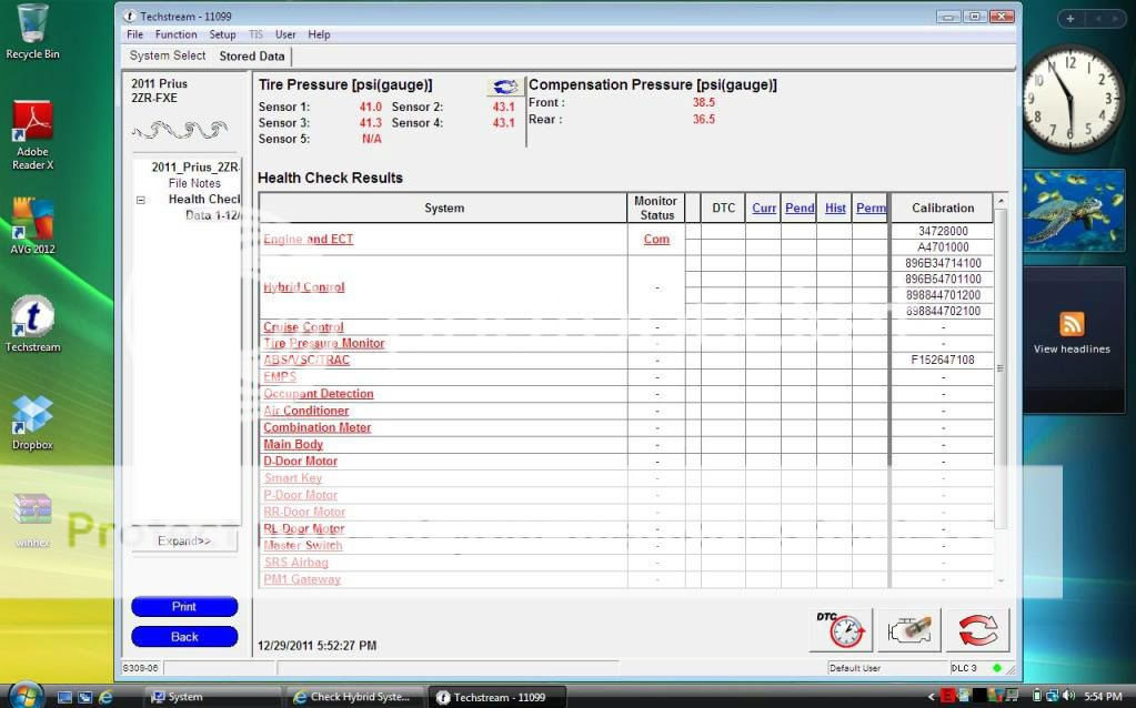

    This is for amusement only, but I've gotta say that it is so much quicker and easier than getting out my pressure gauge. ;)
    Interestingly enough, Techstream gives you the option for a "compensation tire pressure." It asked me what the factory specified pressures were for the front and rear, the ambient temperature, as well as whether the car was: a) cold (sitting for more than 4 hours), b) driven on short trips, c) just parked after extended highway driving (more than one hour). After entering the appropriate values, Techstream gave me readings of 38.5 F and 36.5 R. I am not sure what the software is using as a baseline, but I think those values are indeed fairly close to the true cold pressure that I would have measured.
    I am curious though, how accurate are the pressures being reported. The readings said my rear tires were 41 psi, but I measured 39 psi with my gauge. If the sensors' readings are correct, that means I need a new gauge.
    Overall, this function is probably of little value to most people, and I posted this just because I thought the function was pretty cool. What I do recommend to all of you DIYers though, is to spend the $60 for the knockoff Mangoose cable so that you can get Techstream working for diagnostic use. I must give credit to pjksr02 for directing me to the Mangoose cable and for guiding me through the setup process. :rockon:

    I've found my two pressure gauges vary from the TPMS readings, too. Each reads lower by about 10-15%. Remember, the tire pressure warning system is set off by changes in pressure, so I wouldn't conclude the sensors are more accurate.

    I found that the TPMS sensors in the wheels vary as well. I set my tires to 42.0 front, 40.0 rear with a tire pressure guage. They read back via TPMS as 42.0, 43.1, 40.6, and 41.0. So the difference between my gauge and the sensors varies from 0.0 up to 1.1 pounds.
