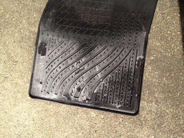

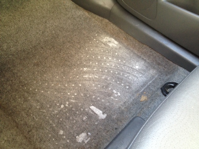

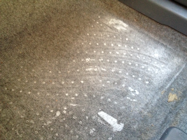

    Thanks for all of the replies... I'm happy to report that I think I've figured it out.
    I took a quick look inside the car for moisture, when I lifted up the mats in the front, I found a lot! I wash and detail quite often and must have put the mats back in before they were dry the last couple of times, thus introducing moisture into the cabin.
    See attached pictures.
    Lesson learned! Hopefully once I dry it all out this won't happen anymore.

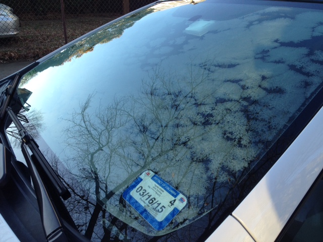

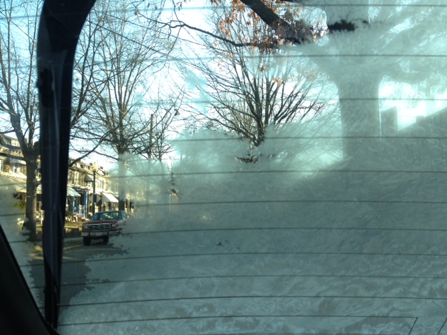

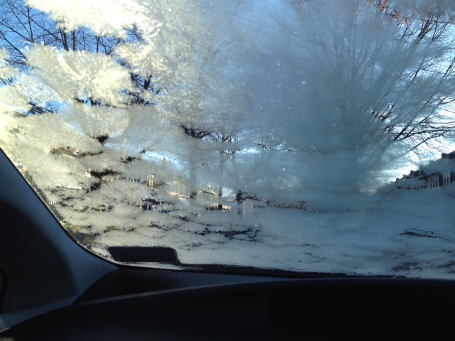

    That was the case this morning.. This started as a fog issue, but as the weather got much colder this week, it started to freeze. This morning when I went to my car the front back and sunroof were all completely frozen on the inside, with nothing outside.
