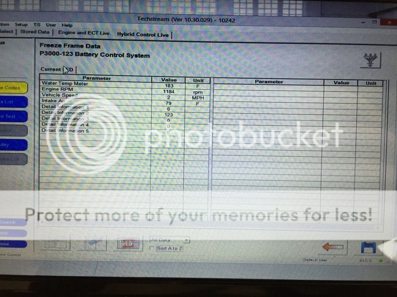

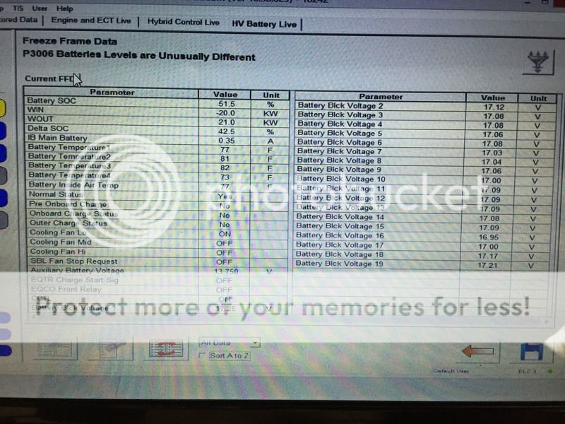

    Update:
    Good News and Bad :-(
    With the generous lead from Dr Wong, I got the Fotga brand MiniVCI from Amazon $22.89. Installed with success!
    Bad News:
    Error Code came back
    Used TIS
    Holy PooPoo
    So after reading some Voltage threads, I assume the battery is toast or at least most of the cells are DOA?
  13. S Keith
    S Keith Senior Member
    Sep 4, 2015
    799
    329
    AZ
    2003 Prius
    I wouldn't say most based on the 0.3V delta between your high and low voltage blocks. Block 16 is low and may be an indication of a weak module within, but the baseline numbers show nothing of major concern.
    You should try this test:
    Predictive battery failure analysis for the Prius Hybrid
    You can plot several at a time within TIS, or you can export them to excel and plot them all.
    Here's where I did my version of the test before and after grid charge/discharge:
    Quantitative Results of Grid Charge/Discharge | PriusChat
    usnavystgc and DRACO like this.

  15. bwilson4web
    28,278
    16,000
    I am hoping @S Keith will add his thoughts but I noticed Google ads for: Prolong Battery Systems. Extending the life of your hybrid. – Hybrid Automotive . My thoughts:
    1. Peak charger - incorporates a fan power supply so the excess heat is removed. This is 'less bad' than trying to balance the modules without a fan or on a bench.
    But I have issues with their understanding of what is going on. The site claims it is "crystals", a poor understanding of the Prius module failure mode, the loss of water from the electrolyte. I think @S Keith can confirm this as have my experiments. Let's go over what is going.
    Over time, Prius modules lose water through parasitic electrolysis with the hydrogen and oxygen gas leaking out the terminal seals. This is accelerated by heat which is a function of driving patterns and climate. This reduces the amp-hour capacity of the module (each module consists of six cells in a shared case.) Since the center modules are hotter than the outer ones, they weaken first:
    • Temp 1-3 - from three modules, 1 closest to control electronics, 3 middle module
    • Temp 4 - air inlet
    • Battery Inside Temp - air exit
    The middle modules age first and lose capacity. Notice the end modules have the highest voltages while the rest have lost a few volts. The problem pair is #16, well removed from the ends, which has lost capacity.
    The voltage imbalance is what happens if you put a "AAA" battery in series with a "D" cell and try to use them in a flashlight with a battery monitor:
    1. Both batteries are fully charged to the same voltage and starts fine.
    2. During discharge, the "AAA" battery, lower capacity, drops its voltage faster than the "D" cell.
    The P3006 code means one of your modules has lost capacity and become the "AAA" compared to the others. Grid charging is the same as bringing the "AAA" and "D" cell back to same peak charge voltage. Only when it is back in use, the "AAA" will drop its voltage first and voila, P3006.
    There is a mysterious 'balance cycle' that the car can institute on its own. When it happens, power is reduced and the engine runs putting a peak charge on the traction battery. DO NOT SHUTDOWN THE CAR but park and let it run its cycle. It is no worse than using a grid charger and built into the car. Check the 'utilities' in miniVCI and it may be something that can be triggered.
    The P3006 is a warning that the pack is weak and needs serious maintenance. You've got a month or so. Your options:
    • Grid charging;
      • A temporary patch . . . may buy time.
      • Check 'utilities' with miniVCI and see if you can trigger a balance cycle (cheap!)
    • Do it yourself:
      • Single modules - becomes 'whacka mole' so expect to do it again. Almost as much work as rebuilding. Expect a weekend.
      • Traction battery rebuild - you'll need 38 balanced modules, Gen 2 or Gen 3 recommended. Takes a week or so of pre-rebuild and then a couple of days to do the swap.
    • Warranty covered rebuilder:
      • I used Dorman when they were ReInVolt six years ago, very satisfied.
    • Toyota repair, also warranteed.
    Fair notice, I'm working on an alternative approach to "warranty covered rebuilder" but it won't be available for a while.
  16. Patrick Wong

    The P3006 shows a traction battery failure. However, since the voltage readings are fairly constant, if this was my car, I would start by opening up the traction battery case to inspect the condition of the bus bars. If they are found to be heavily corroded, try cleaning them first and retightening the nuts securing the bus bars to the modules. Then see what happens. You have to be very careful with the bus bar that has the very thin voltage sensing wires, to ensure the wires are not damaged.
    OP says this is his mother-in-law's car. Hence, he needs to be very careful with the repair approach. IMO he does not want to do the individual module repair approach or trying to rejuvenate a 14 year old battery with a charger. Neither approach is going to offer long term results and he'll have to face his wife and mother-in-law when the Prius inevitably has a recurrence of the problem. Who needs that drama.
    I would also be skeptical of "remanufactured" batteries as recent postings have shown many problems stemming from fly-by-night suppliers.
    Who is going to be funding the repairs? If the mother-in-law can afford $2,500 for a new battery, then I would say have her purchase it and if the OP can install it, he will be the hero.
    If the OP has to fund the repairs, then this could be the MIL's Christmas gift.

    If you've learned anything about me by now, Bob, it's that it takes almost no prodding to get me to comment... :)
    Coming from the Honda IMA community, I've been familiar with grid charging for over a year, and HA is the primary supplier of grid charging solutions. I didn't get confirmation from hm personally, but I believe he states it in such a manner as to appeal to the somewhat more common understanding about why most people believe NiCd batteries fail, rather than explaining the whole concept of voltage depression. This is my opinion about his website content, not fact. However, I can say with 100% confidence that he understands the phenomena and the mechanics of what transpires during grid charging/discharging based on his posts on Insight Central and his understanding of Mike Dabrowski's work (pioneer of IMA battery work, http://99mpg.com).
    Due to the more isolated nature of the IMA modules, and more aggressive use of the capacity range, imbalance occurs more rapidly. Grid charging has been shown to be a corrective and preventative measure for a lot of folks in the IMA world, myself included. It is not uncommon for folks to get another 1-2 years of very useful life out of an ailing pack with somewhat routine grid charging/discharging.
    Your comments concerning hydrogen/oxygen loss through the terminals is new information for me (although you may have mentioned it before). It sounds like a very plausible explanation.
    My understanding of the progressive deterioration of modules is the onset of voltage depression where consistent short cycling create an accumulation of the lower potential H2Ni2O3 at the terminal. Total capacity isn't reduced, but the capacity is delivered at a lower voltage (depressed). The act of cycling dips into this well of lower voltage capacity and consumed it - a little bit with each cycle. Where long slow deep discharges consume it all at once resulting in a near complete recovery of capacity up to a point.
    The fact that one can't always get back to 100% rated capacity is likely the normal deterioration due to cycling as well as your gas loss through the terminals.
    Steve
    usnavystgc, strawbrad and bwilson4web like this.
