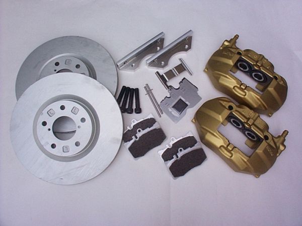

    Here has been my line of thinking lately. Having some brackets fab'd up like this:
    and going with some OEM lexus hardware...just having the rotors redrilled to 5x100 instead of the 5x114.3

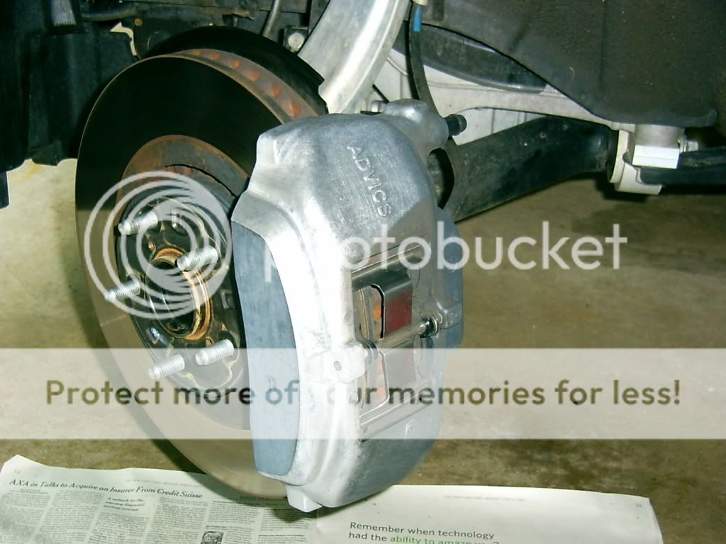

    Seen this from a site in Japan: TOM's BBK... Looks really similar to the UCF30 caliper
    How hard could it be??

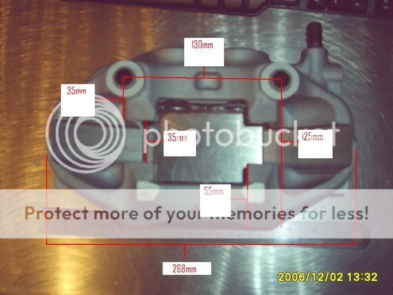

    UCF30 would require 55mm of clearance between the wheel and the rotor based of these specs:
