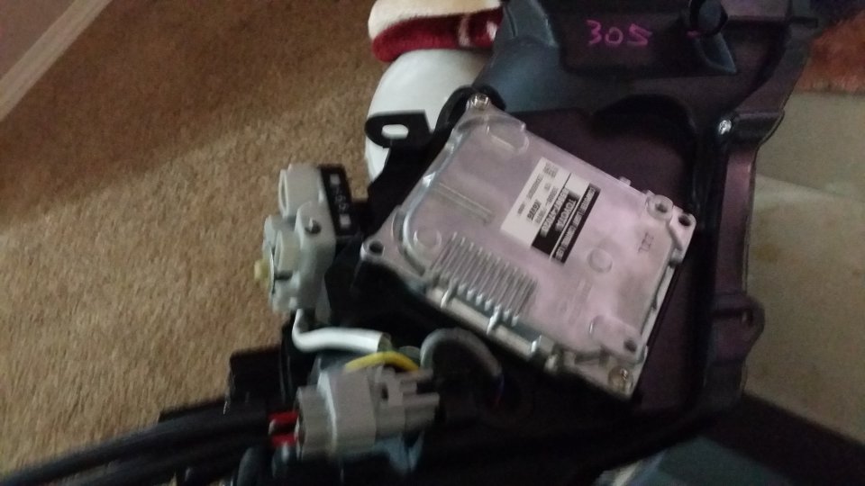

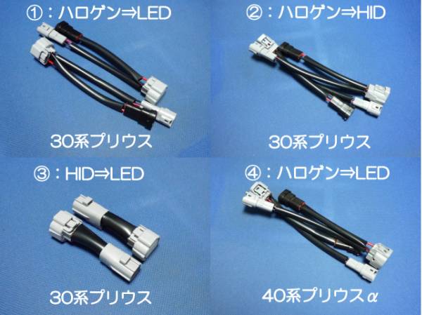

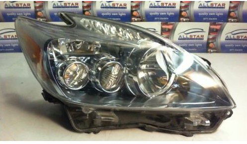

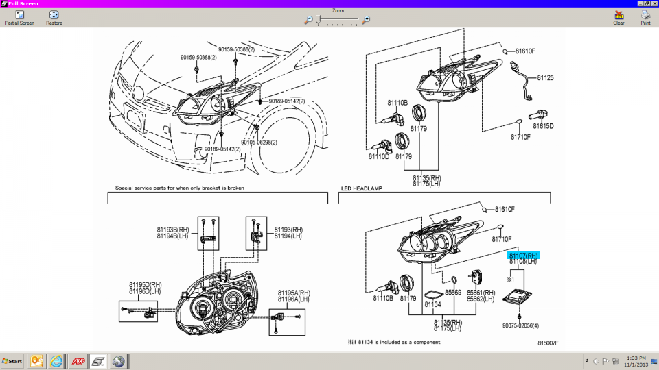

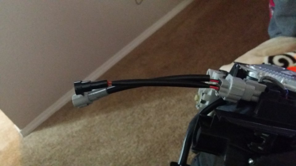

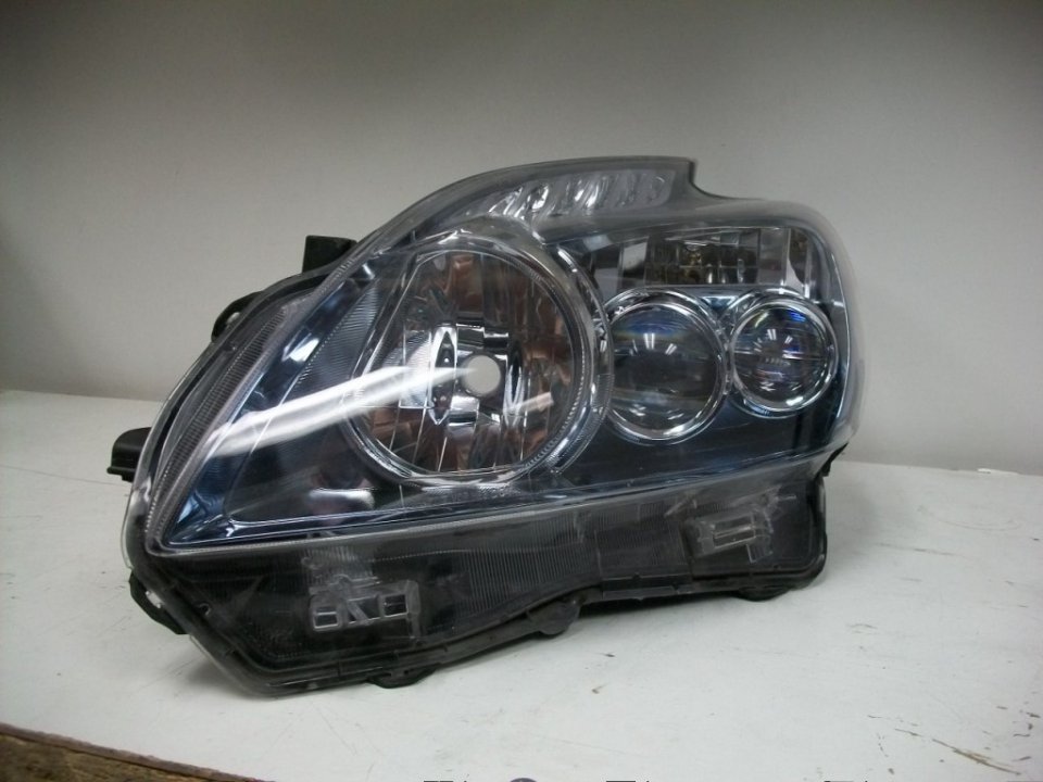

    I making the swap from Halogen to Led headlights on my Prius III, with special thanks to 32k colors, genetiix, and bino for the help. I am at the beginning stages at the moment but I will post pics of current parts that I have purchased so far and before and after pictures as I progress. I purchased the used led headlamps from Ebay. I chose the 2010-2011 headlamp style, because I think the 2012-2013 style looks ugly. One of the headlamps came fully loaded with ballast, and with the help of bino I purchased the halogen to led harness from Japanese auction. FinderScreenSnapz001.jpg 2-24.jpg harness.jpg HEADLAMP ASSY.png I also have a parts number chart from toyota, for every part number for the headlamp unit ( counting broken tabs and screws and led ballast) for anyone wondering the part number or wanting to do the swap as well.

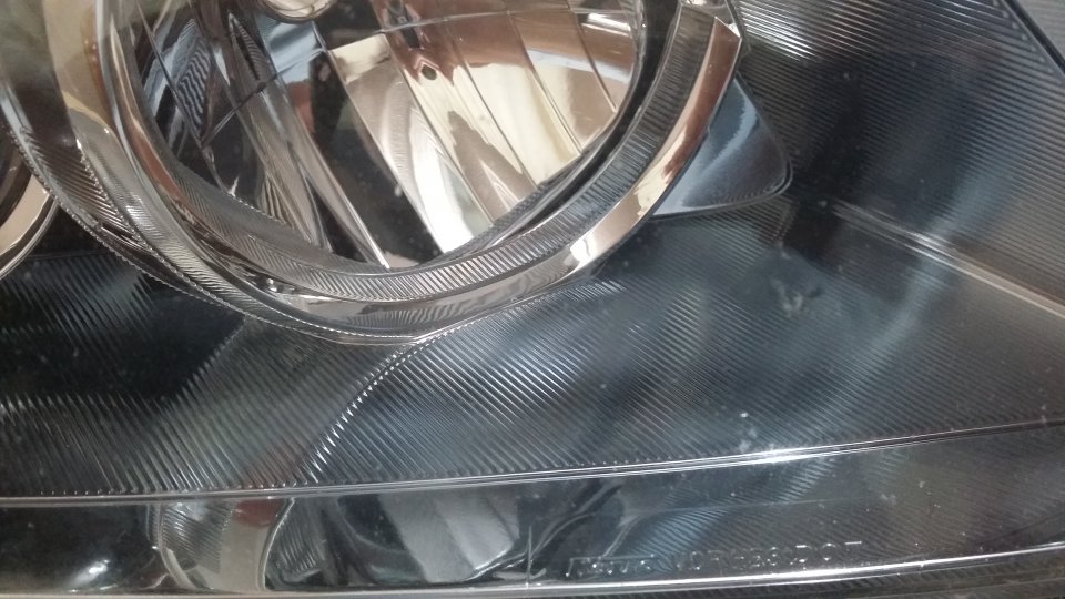

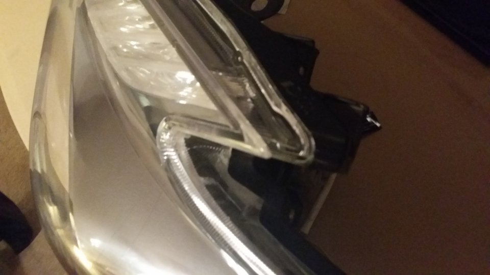

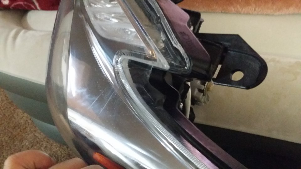

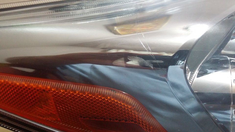

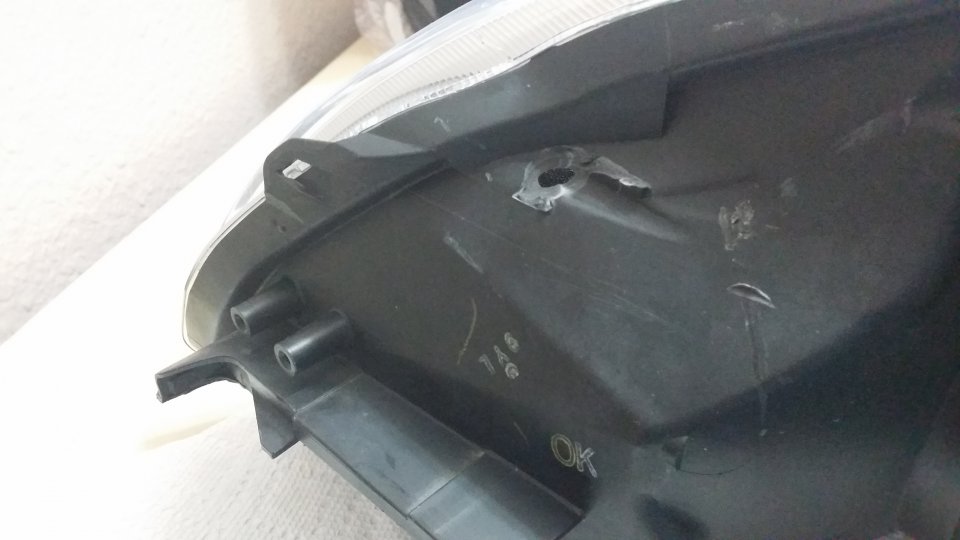

    Update: so both headlights arrived yesterday, they are in fairly good condition but have some rock nicks on the lens, seems like the previous owner must of had a gravel driveway. And as we were talking about before, two broken tabs, one on each unit. I purchased Sylvania head light restoration kit, hope this will help get some of the nicks out. Will be ordering the tab replacement on Friday when I pay my local toyota part guy a visit.
    here are a few pics of the nicks on the lens and the broken tabs 2013-11-07 00.05.54.jpg 2013-11-07 00.07.06.jpg 2013-11-07 00.08.17.jpg 2013-11-07 00.15.00.jpg

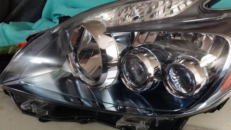

    Update: So I finally got my led to halogen harness. I fixed the broken tab on one of the headlamps, the other tab is not replaceable, it is the tab that the bumper clips on to. I decided to buy some black rubber sealer and seal the hole, and instead I will run a zip tie through the hole on the bumper and attached it to a part on the car so it is secure and does not vibrate or rattle. I did a wet sand on both the head lamps, 400 grit, 1000 grit, 1500 grit, 2000 grit, and finished with a 2500 grit, I cleaned with a isopropyl 15% alcohol then used a compound to fill the hair line scratches from sanding, I polished the head lamp and applied the clear coat. Next step is to let it completely dry and apply the final sealant Opti-lens to permanently seal the lens. I have attached some pictures of the work so far, if all goes well should have the the lights installed by the end of the week :) 2013-11-12 22.45.51.jpg 2013-11-12 22.45.56.jpg 2013-11-12 22.46.09.jpg 2013-11-12 22.46.25.jpg 2013-11-12 22.46.34.jpg

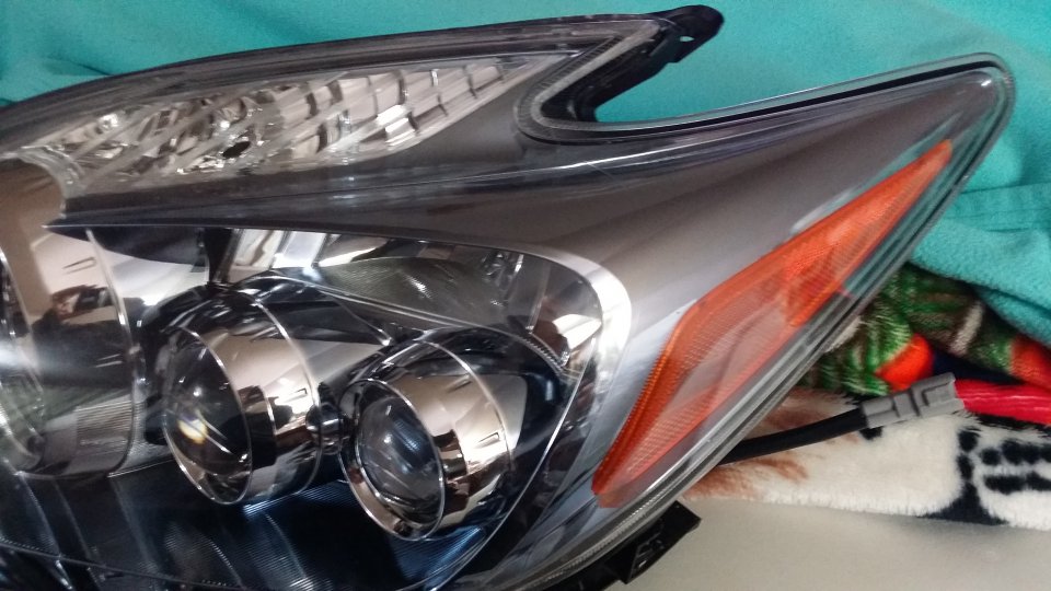

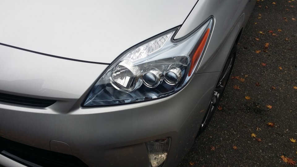

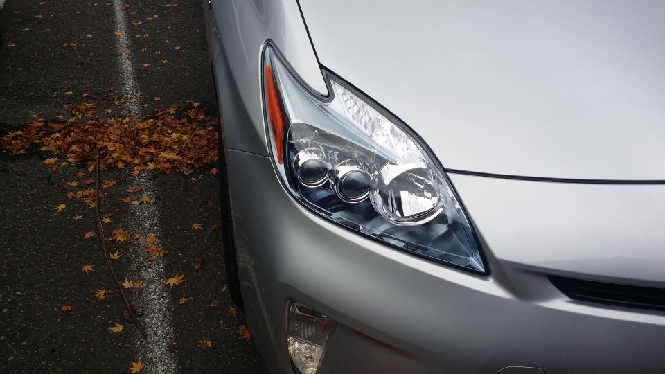

    Update: So today I took my car to a local body shop, they installed my lights :), I have posted pics, one small issue the guy that installed my lights did not connect a wire and the side markers are not coming on (on both sides), spoke with the owner they will take care of it on Monday. Another thing I noticed and not sure if its just the aiming of the lights but my left side, that has the brand new ballast on it seems brighter than the right side with the old ballast. will try to take pics at night time to compare. 2013-11-16 12.12.19.jpg

    Looks awesome! (y)
    Shouldn't be too hard to get those parking lights working, probably forgot to plug in a connector on both sides.
    Make sure they're properly aimed. :)

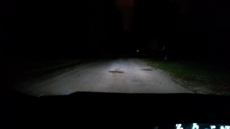

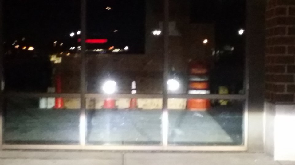

    So I took some pictures at night not the best pictures , so the light I thought was more bright seems to have a shorter beam then the right, here are a few pics, one of the pics is the reflection off a window. On my last Prius I had hid( Morimoto with a denso ballast) and compared to Led, Led is not as bright but much more cleaner light, and I have to say I like it much better. Any suggestions on aiming from picture I took? I was thinking that the left light needed to be aimed up slightly. 2013-11-16 19.41.02.jpg 2013-11-16 22.50.35.jpg
