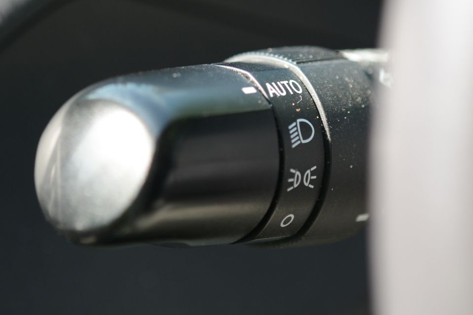

    I have a 3rd gen Prius (registered in late 2009, but technically a 2010 model), with European "Premium" package including HID low beams and LED daytime running lights.

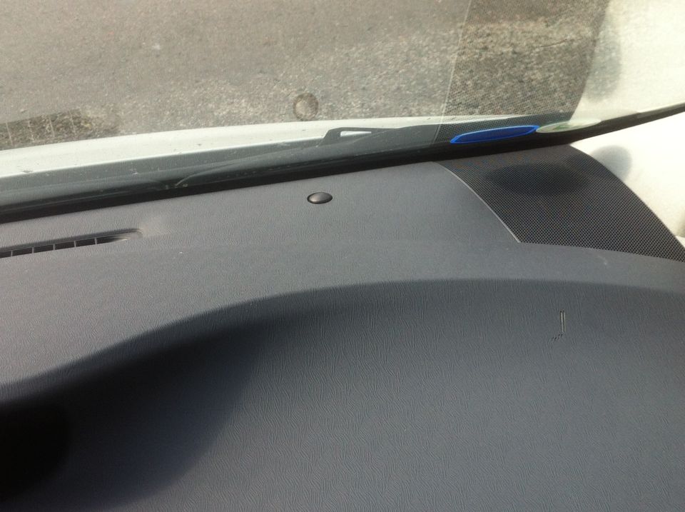

    The car has "auto" setting for lights, so I think it should be able to automatically turn on low beams in dark. At least dashboard lighting and the touch & go screen automatically dim, so there must be a sensor (the black dot in last photo, I think).
    The problem is that low beams are always on (except in "parking lights only" mode). There is no difference between "auto" and "headlights on" setting. My guess is that this is because of the Nordic legislation requiring headlights being always turned on before 2010 (after 2010 daytime running lights were required/permitted in EU). Does anyone know whether the this behaviour can be changed through OBD programming? It really bothers me to run HIDs on daytime, because in the end all the extra energy is coming from fuel, and also because they have limited lifetime (and probably expensive to replace).

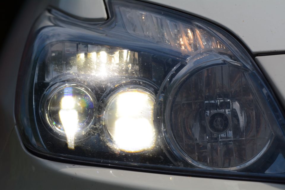

    The above photo is a close-up of DRLs, you can clearly (well, not so clearly in that photo) see the LED element. Actually I thought my car has not DRLs until today I found them when inspecting the lights more closely :)

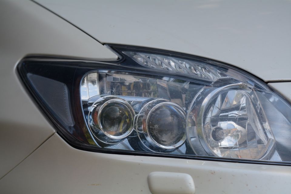

    Hi Yaggo! If your Prius is imported by Toyota Auto Finland ("Scandinavian Spec."), there should be DRL ON or OFF -function in customize parameters. That customization can be done by any dealer using Toyota Intelligent Tester. :)
    Doing so, you need to install for example led DRLs, because the low beams are not running anymore in the OFF-position of the light switch (or when it's not dark in the AUTO-position) and the vehicle is not street legal here in Finland. Like said, here is compulsory to run low beams or DRLs during daytime.
    I did the customization on mine and then installed Philips Daylight Guides to front bumber. I'm very happy with the result, because now the car will decide (AUTO-position) when it's necessary to run low beams or led DRLs. :) Of course heavy rain or blizzard are conditions where i should be wise enough to have lightning in the back also. :)
    Btw, your low beams are not HIDs, they are leds. :) Light output is coming from three separate units.

    Thanks Kanslisti for your detailed information! I confused the upper element of LED headlights for DRL (and round ones for HID). So, my car has neither DRLs nor HIDs, but LED headlights instead. That's actually cool, because now I don't have to worry for wearing or for power consumption of HIDs. I can just keep LED headlights on all time, problem solved.
    Of course dedicated DRLs would consume marginally less energy than LED headlights, but the difference of few watts doesn't make them worth of the effort (in my case). Although I have to admit that Kanslisti's installation looks very nice!
