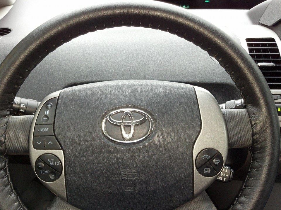

    Installed the Wheelskin cover today using the baseball stitch:
    Unfortunately, the cover was a bit too narrow, so it didn't wrap completely around the entire circumference of the wheel leaving a small gap between the edges of the cover. I didn't want to go through the hassle of sending the cover back and waiting for a custom size, so I went ahead and stitched it on.
    I like the baseball stitch a lot vs. the regular stitch because it keeps the cover straight, vs. having the cover always being pulled at a slight angle, which can cause some bunching if you're not careful. also, the stitching seems to be more concealed and even, with the XXX patterns holding the cover on, as opposed to the /// pattern of the regular stitch.

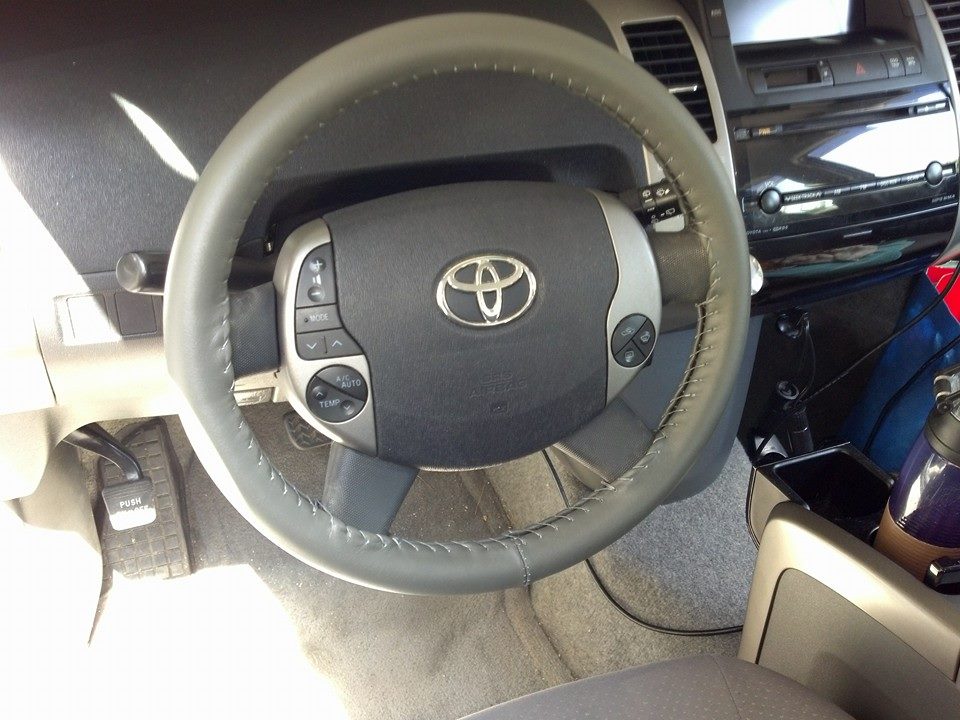

    Do exactly as recommended in the instructions, and if you need help, give WheelSkins customer support a call. Ask for Irene, she's one of the best, and when I got my first WheelSkin cover, it was a bit in the tight side, so she recommended I send her the measurements of the wheel (exact circumference and size top & bottom) which I did, and she sent me a brand new cover of correct dimensions, this one in black (my original order was for charcoal gray, but someone here recommended the black would look better) and Irene sent me a couple of spare lacing threads in case I found someone with a need for my original gray one - all for no charge! (fantastic customer service!) I sent Irene a note saying that she should tell her boss she deserves a raise, and here's the reply I got from her boss:
    Hi William,
    I’m Irene’s boss and thanks for the kind words.
    Irene is a gem and she always solves everyone’s customer service problems quickly and with humor and charm. So, I’m not surprised at your good experience.
    By the way, she just got a raise. Thanks.
    Jim Valley
    President
    Wheelskins, inc.
    Here's my original e-mail to Irene:
    Hi Irene,
    Here's a picture of the installed WheelSkins cover which I received on Monday. As you can see, the fit is much better, and I must say that I'm delighted with it! It is so refreshing to find a company which values Customer Service as high as WheelSkins obviously does. Thanks again for all your help and valuable advice. Tell your boss/supervisor that I think you deserve a raise! Thanks again WheelSkins for a splendid product, and a timely solution to an awkward problem.
    Sincerely,
    William Henry Davis
    ...before (see the gaps?)
    ...and after! (tight as a duck's bum!)
    PS: Make sure you keep it tight as you progress with the lacing! Tight is Right - you won't break the thread, it's waxed and very, very tough!
