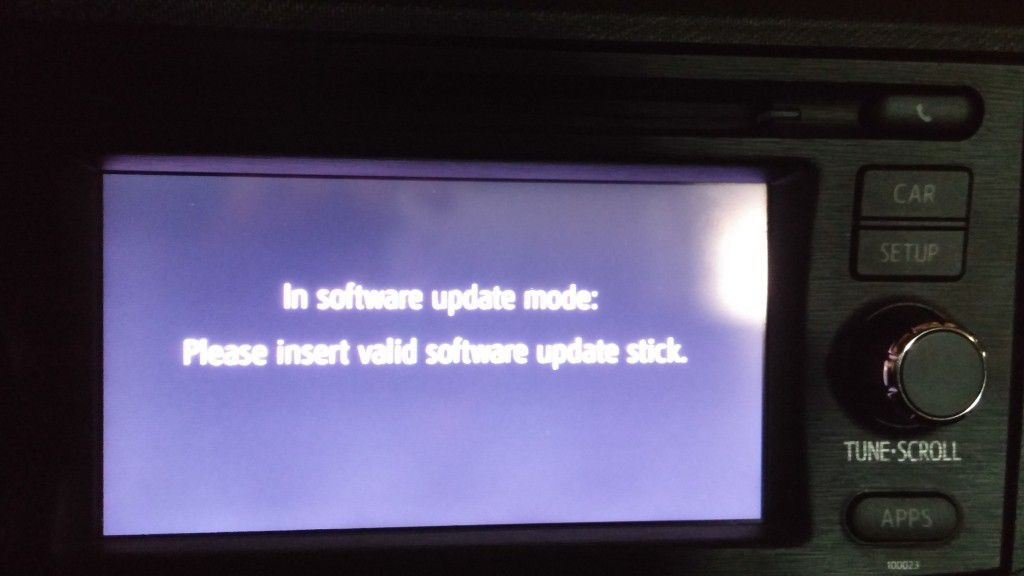

  11. daddyd302
    daddyd302 Junior Member
    Aug 20, 2014
    48
    West Allis, Wisconsin
    Well this turned into a DISASTER!! I was gonna try to update mine and now it's stuck in software update mode, please insert valid update stick. I cannot get anything to work, no apps no mode switch. I'm stuck using my cd player and it will not switch to anything else. I tried 2 different usb sticks, one using fat32 and nothing it will not update or get past this screen. I did everything as suggested on that website....
  12. ftl
    ftl Explicator
    Jun 2, 2009

    When you formatted the USB as FAT32, did you give it the volume name mentioned in the instructions?

    I named it 14A. Like I said, I did everything that website suggested. The problem was it never asked if I wanted to update from XXXX version to this version. It just said updating then that screen popped up.
    I've googled this problem and there's nothing on it. I can't even reset entune.

    You may have to try disconnecting the 12 volt battery and leaving it off for a few minutes. This will force everything to reboot when you reconnect it.

    I can get the negative off, but I can't get the positive off. I don't know how to remove the top part of the seat. From this thread I can see part of the top I need ot take off but I don't know how to get that part off.

    You need to disconnect only one lead, doesn't matter which one.

    I took off the negative and left it out for 5 minutes and nothing happened. Looks like I'm SoL until I can call the entune hotline on Monday.
    EDIT: Nevermind I forgot what a pain it was to put back the push caps on bottom part of the seat. I almost broke a few of them. I'll just call Toyota Monday, thanks for the help guys.

    It isn't trying to update via a cell link is it?
