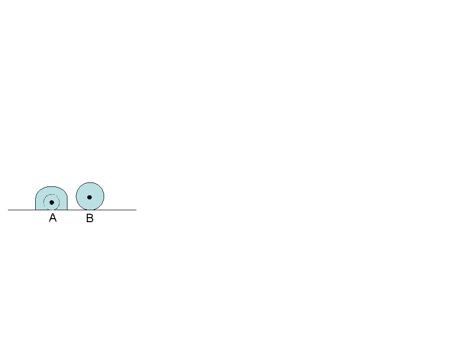

    The way I think of this can be seen in the crude picture. In image A is my attempt at showing a flat or under inflated tire. Image B is a "perfect" tire or one that is greatly inflated. The black dot in each tire is the center or axle of the tire/wheel. Note that axle A sits closer to the ground than does axle B. The distance from the ground to the axle in each case is the effective radius. Rotating this radius around in tire A gives the dotted circle. This is the effective circumference for the flat tire. The effective circumference of tire B is that of the tire itself since it doesn't deform. Circumference of tire A is much smaller than that of tire B.
    Even with radial tires, as you deflate the tire the axle sinks closer to the ground and the effective circumference decreases. It would be the same as you added weight to the vehicle causing the tire to look more and more like A as the weight is increased. Therefore as the wheels turn each revolution of tire A will move the vehicle less far than tire B and hence affect the odometer reading. Underinflated tires (or over weighted ones) will travel less than the odometer shows (assuming the car company calibrated the odometer to properly inflated tires).
    One question I have is the exact relationship. Does a change of say 1 psi when the tire is at its maximum inflation have more or less effect on the effective circumference than 1 psi when the tire is sufficiently deflated? My guess is it doesn't and the relationship is non linear. Once the pressure is sufficiently high, there will be essentially no deflection in the tire and the effective circumference will be the same as the apparent circumference. Adding more pressure will not make it deform less at least up to a limit.
    And what overall is the effect on mpg of tire inflation? There are other factors that come into play such as rolling resistance. I wonder how well the studies were done when mpg was determined for tires under different inflation pressures.
    his line of reasoning does not require that the tread be able to stretch.

    <div class='quotetop'>QUOTE(kram @ Oct 5 2007, 05:43 PM) [snapback]521953[/snapback]</div>
    Actually your drawing shows my point about the tread length remaining the same. In your B drawing it is obvious that the tire, when fully inflated, is connected to the wheel rim and does not move. The rotaions per mile can be calculated.
    In your A drawing, you state that because the hub or rim is closer to the ground that the effective radius is smaller. If this were true, then the outside tread would move slower than the new effective radius portion of the tire. This would tear the tire apart. The outside tread is still conneted to the rim via the sidewall. This new effect radius would turn faster than the tread. This is not possible.
    Therefore with the tread still connected to the rim via the sidewall, the tire will not have any change in revolutions per mile as still as long as the tire tread is in contact with the ground and does not slip.

    Actually Kram is quite correct in his analysis. What changes with an underinflated tire is the amount of thread in contact with the road. It should be obvious that in drawing A, the axle (and engine) would have to spin much faster at the same speed. Higher RPM alone would reduce mileage, and the added friction in the underinflated tire would also cause energy loss, not to mention heating up the tire and causing tire failure.
