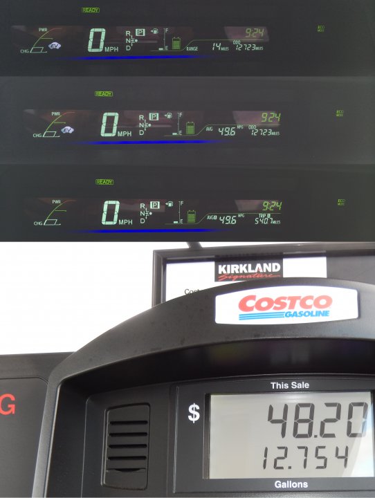

    Just wondering just how many gallons of gas the Prius v is suppose to hold.
    On this tank of gas, it says I have driven 540 miles with 14 miles left in the range.
    Down to one notch on the gas thing, and it is still not blinking yet.
    I went to fill up with gas and I did top off more than usual, but I did stop at 12.7 gallons. IMG_1307.jpg

    Toyota claims 11.9 gallons In 111 fill-ups, I only have one over 11 gallons: 13.1 last December. It never blinks, when miles to empty gets to about 10, an orange gas pump illuminates.

    I have to say that if your pump is telling you it put 12.7 gal in there, its lying. That or you just filled the entire evap system with gas. Once when I had a pump that didn't shut off on its own and ran over from the filler neck, it still didn't take more than about 1/4 gal over what it usually takes (including the cup on the ground).

    Sounds like an overfill to me too.
