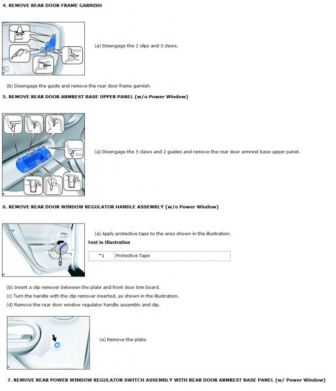

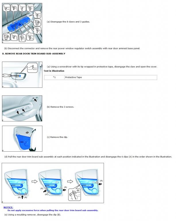

    another helpful how-to:

  3. SquallLHeart

    some plastic panel removers are good for getting enough leverage.. flathead screwdrivers can also work fine, but you need to be more careful not to mess up the plastic

    thanks, ended up using an old credit card I had lying around. Worked pretty well.

    What's wrong with the pictures? I cannot see them.

    ack!!.. the forum change jacked up my links.. um.. lemme try to fix that.

    Don't meant to sound dumb but I am new to this. Both of the info sheets start at step 4 in my phone. Not sure if it is bc of the mobile site or if that is where they start. Could someone either post a link to the full data or send me a copy of it to my email. I would so appreciate it.

    they start at step 4. i believe steps 1-3 were something unnecessary like disconnect your battery or something and was purposefully omitted.
