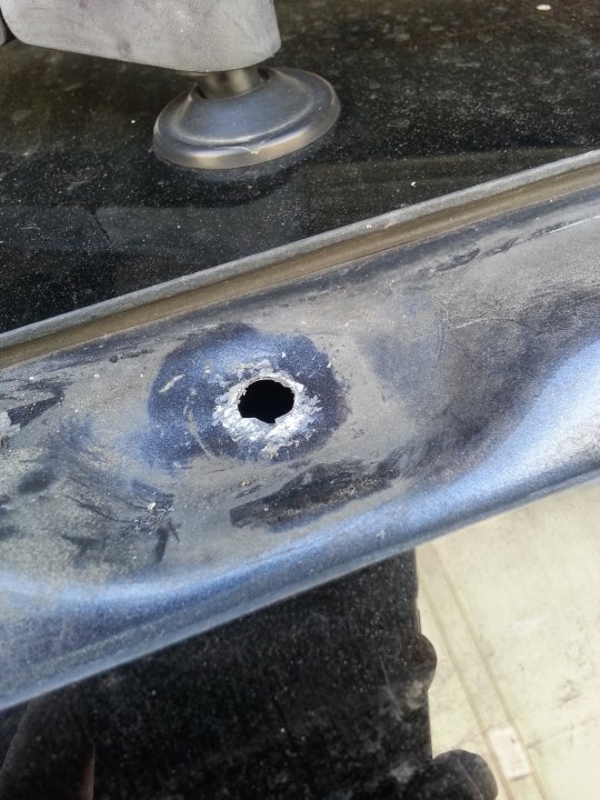

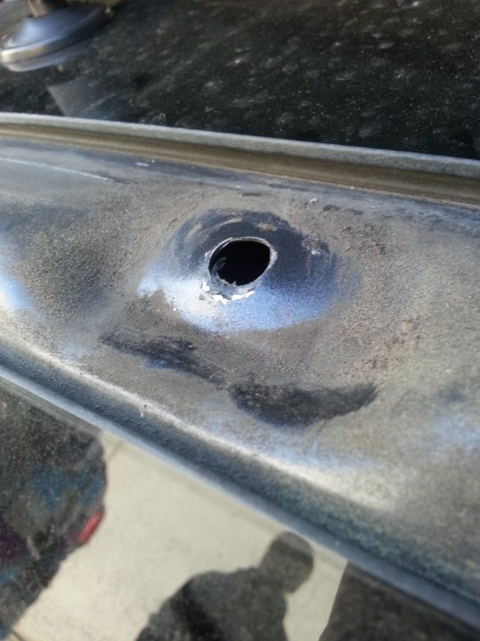

  18. tyang54
    tyang54
    Expand Collapse
    Junior Member
    Santa Clara, CA
    If you go to parts.com choose : Toyota>Prius>Touring (or Base)>Body hardware>Lift Gate>Spoiler you can order a new spoiler $248.78. It is not clear what color you get or if you have to paint it later.
    I had the same encounter with the garage door while the hatch was open and was able to repair it with minimal cost.
    The trick was to make sure that the metal underneath was bent bent back to its original shape. When the spoiler pulled loose it actually bent the metal into which the spoiler was bolted. The spoiler clips were not connecting because the bent metal lifted the spoiler higher than it should have been. Once the metal was pounded back down, the spoiler fit down flush and the clips locked into place.
    I managed to break off one of the plastic female ends of the clip and ended up using JB Weld to glue it back in place.
    metal is pulled out...
    make sure this metal is flat with the surrounding
