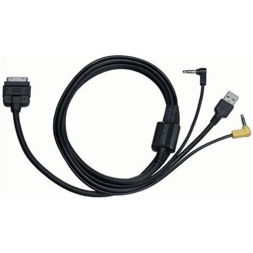

    Hi,
    I have two issues with my setup. When I connect the IPOD, it is recognized and plays the playlists etc. But there is no sound at all. When I connect a USB stick with MP3 on it, those play well - audio is good. Audio is an issue only when I connect the IPOD (an older one with video).
    How do I control the AUX Input in the front. When I connect a device there, which source do I select to be able to play it?
    Thanks,
    Chiru
  16. Offline
    usbseawolf2000 HSD PhD
    Start a Conversation
    Member Since:
    Sep 22, 2004
    Posts:
    11,332
    Likes Received:
    1,770
    Queens, NY
    Your Vehicle Year:
    Chiru,
    Which iPod cable do you have? My KCA-IP301V cable plugs into the USB cable and two other 3.5mm headphone size jacks (black and yellow) to the back of the head unit. I would make sure the black one is connected as I think it is for the audio, the yellow is for video and USB is used to control the playback. You can check here to see if your iPod is compatible and which cable to use.
    I have used it a few times. I believe there is AUX source to choose.
    [IMG]

    Hi USB, thanks for the prompt reply. I was able to finally make the AUX work.
    Still have issues with the IPOD/iPhone 3GS. I am connecting the IPOD to the USB cable via the standard IPOD cable to USB (The ones we use to connect to computer for iTunes). The IPOD is recognized and it plays the songs etc. But there is no sound - no audio at all. I tried a lot of options, to no avail.
    But your input on the cable is interesting. May be we need one to use the IPOD.
    I had a Pioneer set before (AVH-P3200DVD) and that had a front USB port that takes an IPOD to USB cable and plays it just fine.
    Your thoughts please,
    Chiru

    Hi USB, You are absolutely right. Called Kenwood support and they said that the cable you mentioned is required.
    I will have to pull out the unit once again to install the cable. I am not looking forward to that.
    When I do that, I am planning to make hole in the Scoscheside tabs (on the left) and install the microphone there. That way I don't have to route the cable.
    Thanks again,
    Chiru
