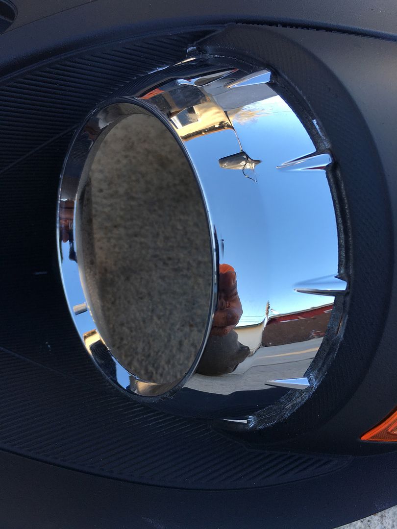

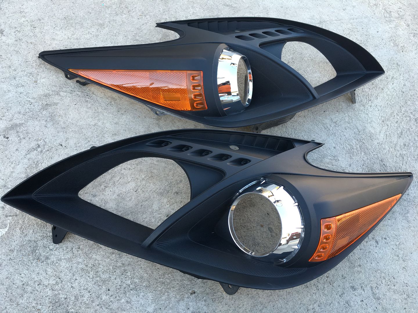

    Used 3M precision masking tape on the chrome ring..for some WIP....
    update to follow!!

    Those look real clean.
    I'm normally pretty torn on blackouts but those are 10/10.

    I used some standard blue painter's tape on one of these. Some of the chrome laminate lifted off the inner edge of the ring. :(

    Nice Job and very clean lines

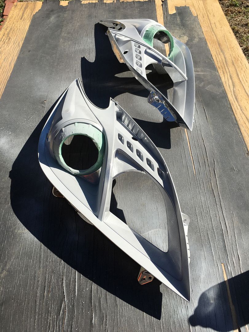

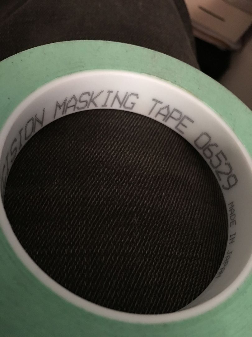

    Thanks guys for that tape I did a lot of research and the tape is very easy on the chrome..
    @ fotomoto green tape 3M Precision Masking Tape 06529 is much much better… $5-6 bucks
    @ Swampthingg man the masking is a really hard on the inside of the ring
