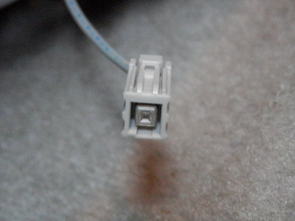

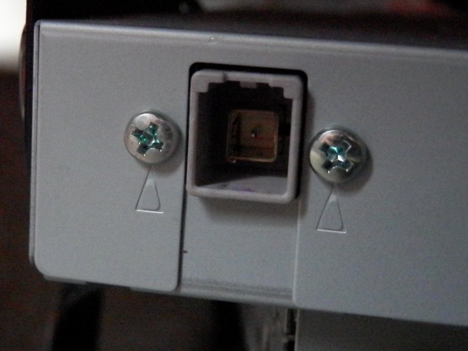

    Jim, yours sounds like mine, only air bag connectors under the seat on my 2010 III, I think you'll find your attaches straight to the back of the radio. I bought the "Terk by Audiovox XMICRO2 XM Mini Roof Mount Antenna" but the plug on it wouldn't fit the proprietary plug Toyota used on the back of the radio, with the FRA3M Antenna adaptor from TSS Radio it goes right together ( I did have to shave one of the guides with a razor blade to get it to plug in to the radio) Here's the adaptor cable, it comes with about 30" of cable
    here's the back of the radio with the factory blue plug and wire.
    It's not hard to get the dash apart, takes a plastic pry wedge or trim tool and a 10mm socket to remove the 4 bolts holding the radio in. I took some pictures of pulling the console and dash if you need them I can post them.
    Honestly, after I pulled it apart the first time, I pulled it apart, installed the adapter, replaced it all and ran the wire to the rear in maybe 4 hours taking my time.
    Here's the finished product, works great, very clear signal, and not too bad looking. Total investment was just under $70.
