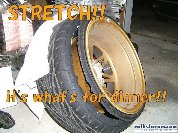

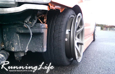

    I wouldnt trust any info on the internet without double checking. both tire rack and the official dunlop site contradict the acceptable wheel widths listed on that site.
    Dunlop SP Sport 01
    SP Sport 01 | Dunlop Tires
    so people stretch tires all the time. nothing ever happens. but when it does....
    is it worth it?
