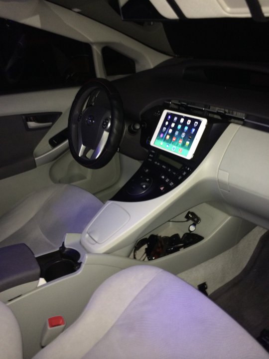

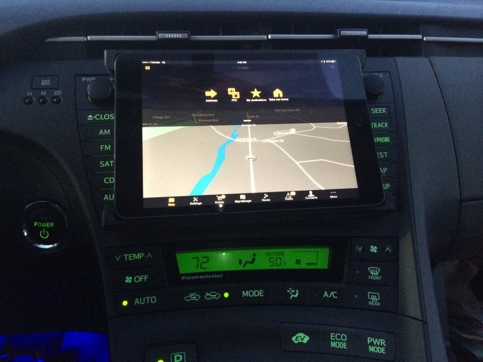

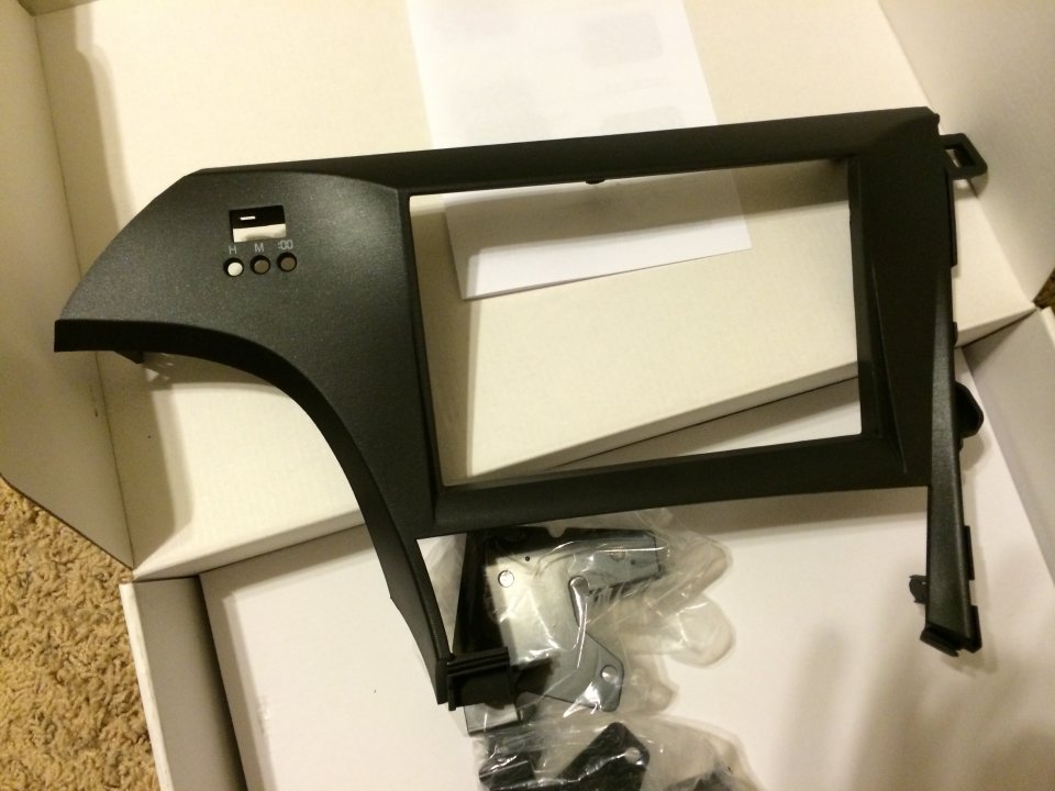

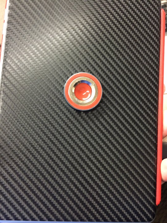

    IMG_1771.JPG Inspired by @xcuter to install a tablet in the dash, I have decided to use an iPad mini Retina. I have purchased the Alpine Perfect fit kit and I'll be posting pics as the work is completed. Here is what I recently received. My plan is to mold plastics and use magnets to create a dash with a removable tablet that I can take with me, won't be stolen or overheat while parked at work, can be updated regularly and still be a functional GPS, Music/Movie Library, LTE mobile usage tablet.

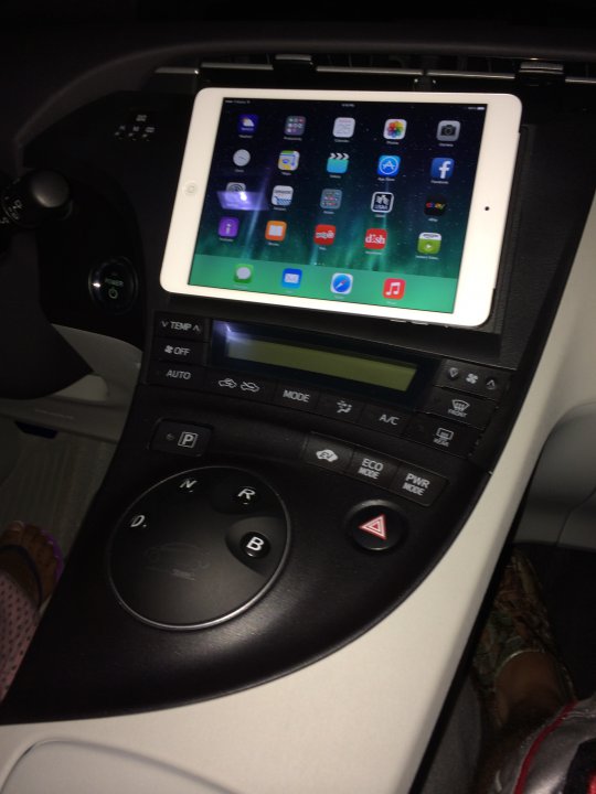

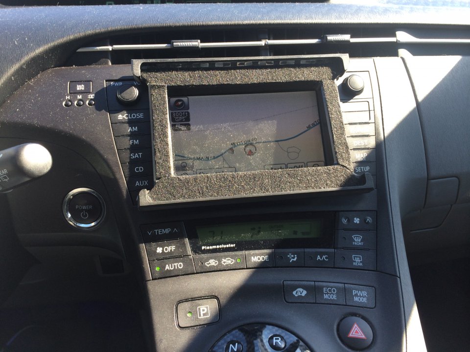

    stock.JPG ipad.JPG Night Pad.JPG Good Luck with your project.....Did the same and love it!
    Wanted to keep access to stock Nav/radio and drop in and out with magnet ease.
    Still have access to all buttons when in use and pairs up with both iPad and iPhone at same time.
    View attachment 66235 View attachment 66237

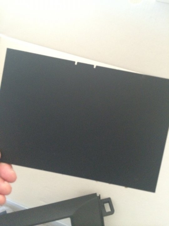

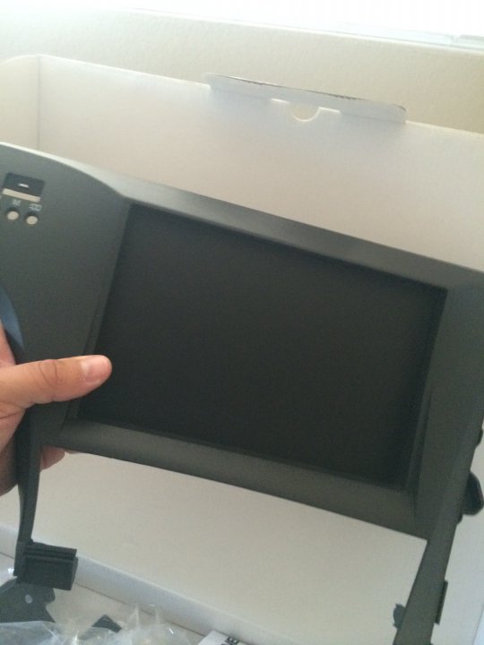

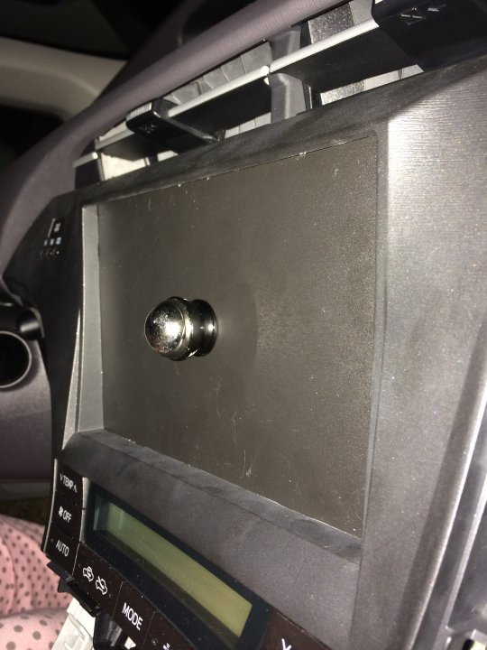

    Custom cut matte plastic from Tap Plastic in sacramento. This will hold the magnet and cover the space in front of the stock faceplate I'm going to remove.

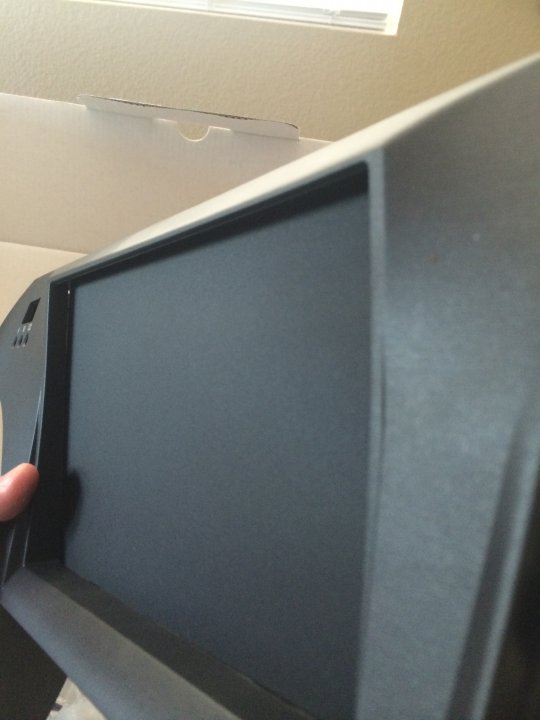

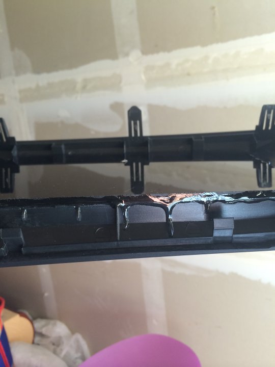

    Molding the plastic to the Alpine dash kit...
    Using the adhesive to bond the cut plastic with dash kit. Recommended to wait 24 hours for the proper seal.

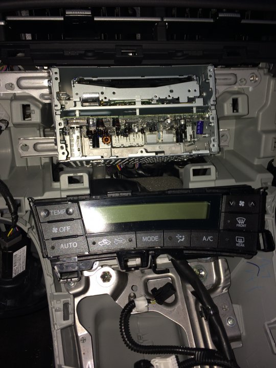

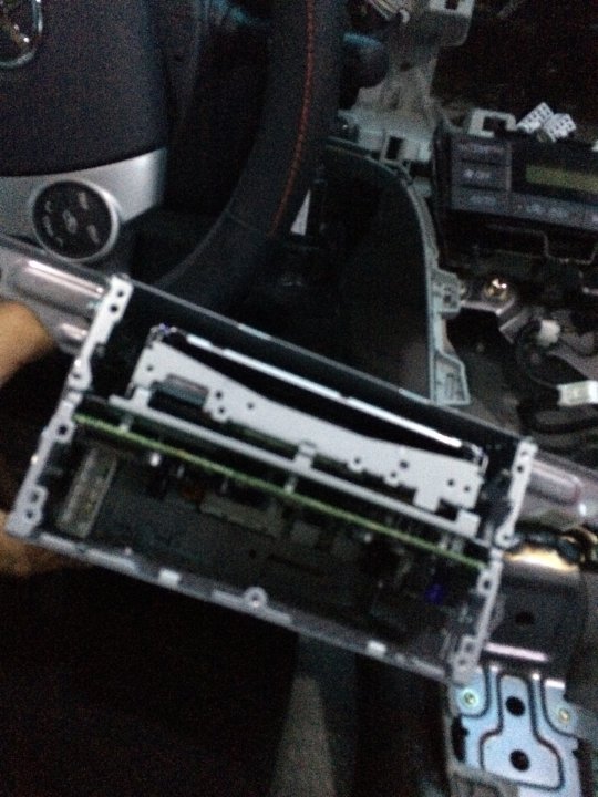

  10. C.R.E.A.M.
    C.R.E.A.M. Member
    Jun 17, 2014
    55
    68
    39
    Sacramento, CA

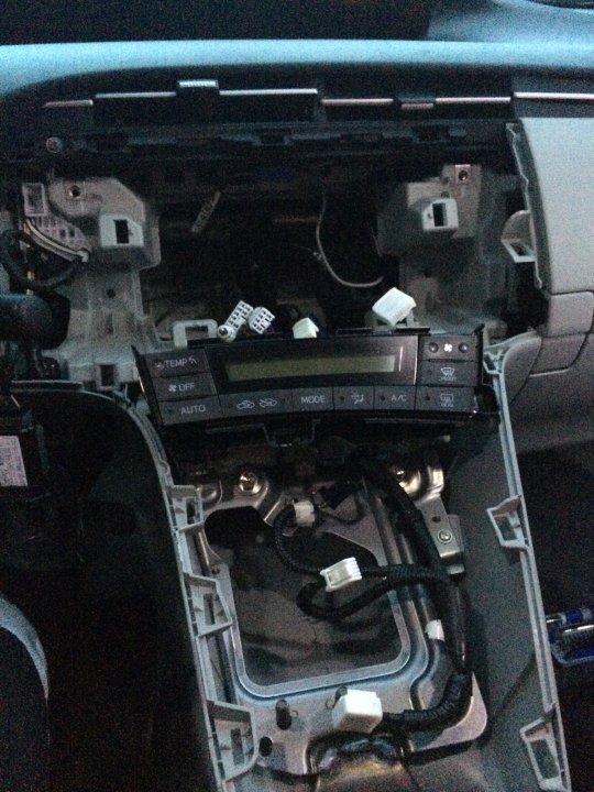

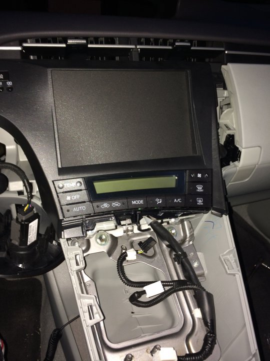

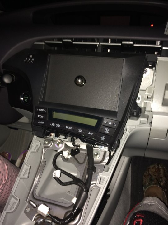

    Progress of the work
    Took apart the dash
    Removed the faceplate
    Keeping the stock radio because I can control it with the steering wheel
    mounted the modified Alpine kit
    #10 C.R.E.A.M., Jun 26, 2014

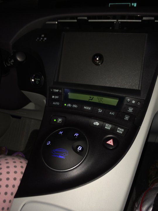

  12. C.R.E.A.M.
    C.R.E.A.M. Member
    Jun 17, 2014
    55
    68
    39
    Sacramento, CA

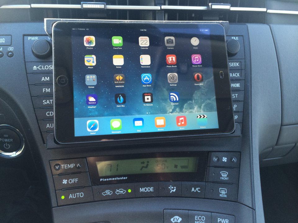

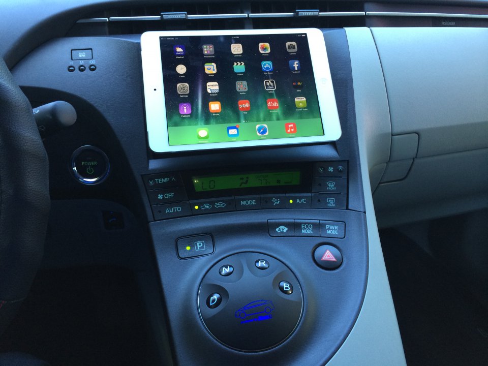

    Complete
    EastTexasPrius and BPZVW30 like this.

    39
    Sacramento, CA
    Thanks! I might move the magnet later, it's a little off-centered. I'll have to buy a new one because it's 3M and not re-useable.
    I personally think it looks really good with the Stage 10 shifter.

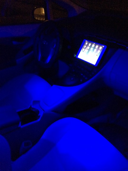

  20. Captain Lucian Chiroptera
    Aug 6, 2014
    40
    Oregon
    2014 Prius c
    just curious, do you have any issues with sun glare? I would imagine the glare coming off of your iPad would be pretty blinding, catching the sun, seems that would be a problem...
