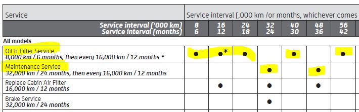

    My dealer tries to hand me this schedule paper every time I visit:
    http://i.imgur.com/1qCfjad.jpg
    It's in French, the oil change entries are the ones listed for 51.95$, like the first one at 8000 km or 5000 miles.
    Is the dealer trying to up sell the maintenance?
    Can I simply delay the oil change and not void the warranty?
    or how should I approach this?

    This is a snapshot from page 25 of the 2014 Prius (hatchback) Owner's Manual Supplement, put out by Honda Canada. In their wisdom, they explain the maintenance for EVERY Toyota vehicle. At least now they include a spread sheet format summary. It's confusing (as always), but look at the yellow highlights in the following. Both "Oil & Filter Service" (obviously) AND "Maintenance Service" include an oil and filter change. So, with one service or the other, you still have an oil change, every 8000 km's (roughly 5000 miles) or 6 months.
    FWIW, I'm nearing the end of power train warranty, and with our usage of late getting down to 6000~8000 km's per year, I may switch over to the US schedule, doing one oil change per year, once it's out of warranty.

    Yes, unfortunately they're still requiring 6 months/8,000km intervals for oil (except the first 3 as Mendel Leisk posted).

    Tidelands, I'm confused: there is an oil an filter change at the first 3 service intervals.

    I'm basically saying you're right lol. It's O&F, O&F, O&F and then the 4th one is the full maintenance Service and alternates between O&F and Maintenance thereafter.
