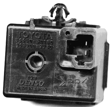

    Have you tried leaving some carrion under the hood for a coupla days?
    How about the sound of the brake pump running? Do you ever hear that whirrrrrrr-CLICK under the hood when first turning the key on?
    Getting a little OT, in my car there doesn't seem to be anything wrong with the buzzer itself ... taken out and with 12 volts applied, it makes a pretty convincing buzz (more like a high B♭ beep really). So maybe I don't completely understand the conditions for the ABS ECU to activate it? The manual just says low accumulator pressure, but I don't hear it even after pumping the brakes to the point they go rock hard. Anybody know more about the actual conditions for the buzzer to sound?
    -Chap
    By the way, this is what the buzzer looks like, in case anybody else needs to get it out; in place it's hard to see the clip that holds it in place or how to squeeze it (I'd use longnose pliers if there's a next time). The + terminal is the one near the keyway (bottom, in this photo).
    #11 ChapmanF, Jan 22, 2015
