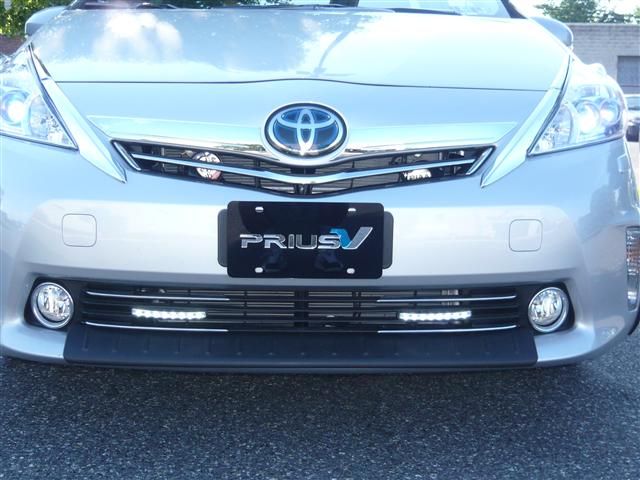

    [IMG]
    I did try to adjust the angle so that I can see PIAA on both side but no luck! :(
