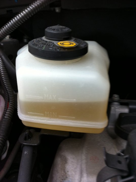

    1. Brake fluid. I understand it is more time related than distance and it needs to be changed every two years in humid climates and London, UK is such a place. But I have impression oil had been changed during previous maintenance: it is almost max level and the colour looks good too. See attached pic. Any thoughts on this? Change or not?

    The brake fluid should not be touched "do not take the cap off" it is a sealed system and the only way dirt and moisture can enter the system is by unnecessary removal of the cap. London is wet but not humid like say Alabama.
