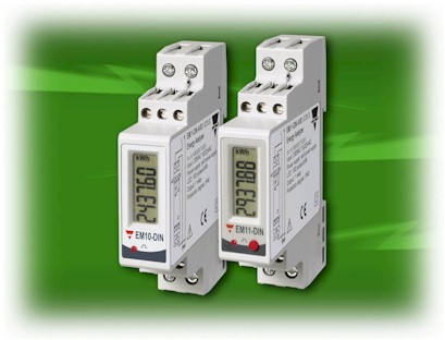

    I never received a response from P3 International, which makes the Kill-a-Watt. Some googling resulted in finding a reasonably inexpensive 240V basic $90 power meter mentioned on an EV forum:
    Basic kWh Meter 100A 120/240-volt, 3-wire, 60Hz EKM-25IDS
    TED is overkill for me and more expensive at $200. The utility electric meter is cost-effective, but is a lot larger in size.

    For the 120V I happily use the Kill-A-Watt
    I mentioned somewhere I have a TED5000 as well, but haven't gone around adding a secondary CT & MTU. You may also find the following items useful for 240 V:
    http://www.ekmmetering.com/
    If anyone has successfully done the 'split' of the 240 V and added the Kill-A-Watt on one of the 'live' wires please post your experience. I would then recommend doubling (or setting to $2.00) the electricity rate price to get accurate pricing or kWh usage straight off the display.
    Not sure if anyone has measured the power function of the battery charging, I assume it must be quite close to 1.
