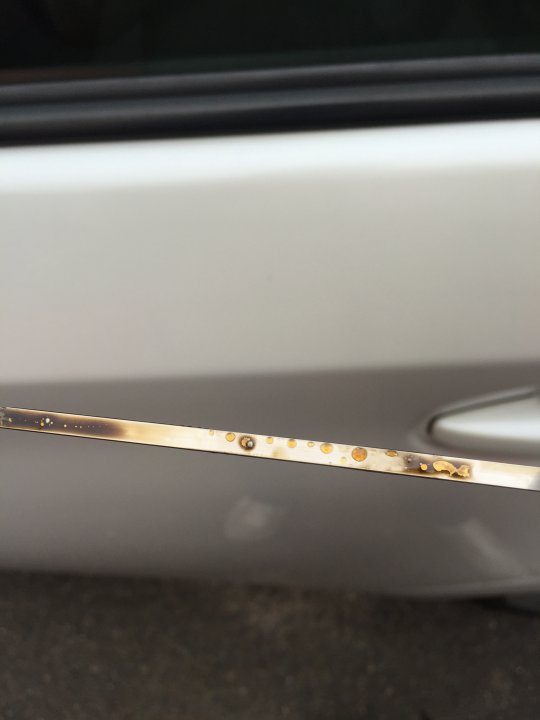

  15. Baz2473
    Baz2473 Junior Member
    Feb 8, 2015
    37
    16
    Kent. England.
    image.jpg Just noticed this on my dipstick!!!
  16. Mendel Leisk
    60,184
    41,397
    Yeah, were you spraying water in the engine bay??
  17. Baz2473
    Feb 8, 2015
    37
    16
    Kent. England.
    No. No water anywhere near the engine bay.
    Does look like water in my oil though doesn't it.
    If I wipe it clean then re dip it, it then comes out looking like normal?
    I'm completely baffled. This car has had no problems at all up until now.
  18. edthefox5
    edthefox5 Senior Member
    Jul 25, 2007
    10,096
    4,833
    Clearwater, Florida
    Again get under car and see if the bad sound its making is in the lower end. If so you have a main bearing failure and that's why its showing a misfire. It may have poor acceleration also as the knock sensor is pulling timing.
    Your loads of running low on oil blew the motor.
    Start looking for a new motor.
