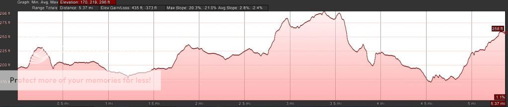

    If it's me you asking, there are a few hills along the way. But, IIRC, my MPGs on the way to work were around 65 MPG.
    I only pulled out my camera once I got back home. No cameras allowed at work.
    Here's a rough profile of the trip to work. I'm not sure how warm the engine was when I left.
    I think it was cold. Since I only stayed about 2 hours, it was still warmed up a bit when I returned home.
    (taking the same roads).
