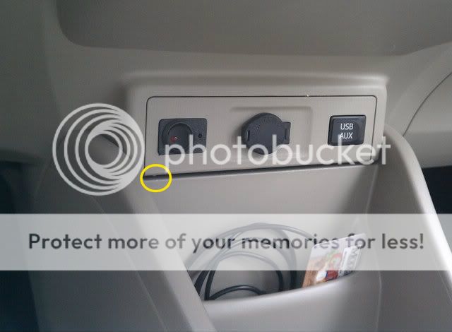

    Seriously, since you asked, a four-fold price increase seems awfully steep. Do you know anyone who has worked on car stereos before? The actual cutting of the wires (technically only cutting one wire, and tapping into two more) is really not that bad. For reference, I've installed probably 4 car stereos in my lifetime, and have only basic electrical (mostly home wiring) knowledge. (Just saying I'm by no means a professional mechanic or installer, so anyone with basic skills like this should be able to do install the PC shop switch.) The risk of real damage from "messing up" is very low - even if you cut the wrong wire, or decide to undo the whole thing, you can just splice or crimp the wires back together, and it's practically back to new. As long as you don't forcefully pull wires out of a harness, you'll be fine. In my opinion, the greatest risk you run by doing this installation is scratching one of the dash panels while you're removing it. For instance, the worst damage as a result of my installation is this little ding, and that's only because I wasn't being particularly careful:
    [IMG]
    Anyway, if you know anyone who's done any basic car stereo work, you could offer them $100 to install this override, and after parts + labor you'd still be at HALF the price of the Prestigious.
