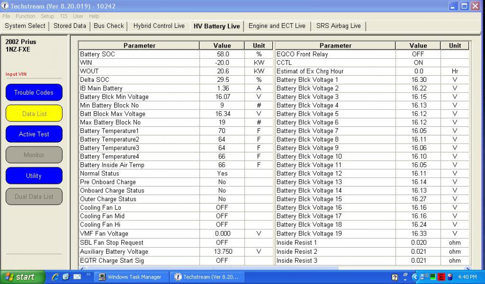

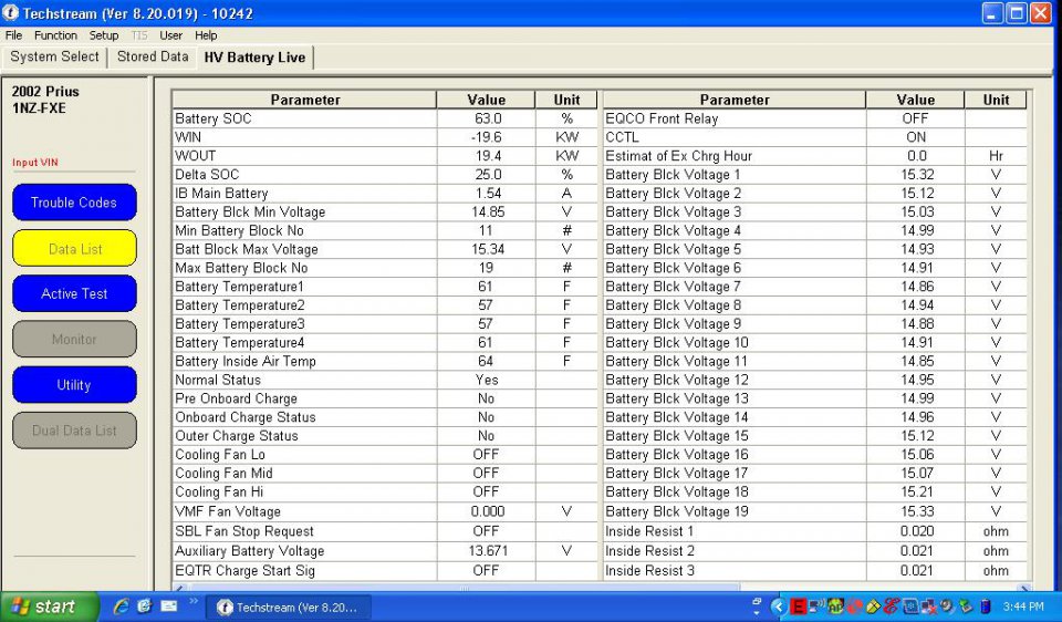

    Here are two snap shots of the state of the battery. The first was when I just plugged the unit in after the car had been sitting for 24 hours. I then played with this scanner for about an hour with the car cycling on and off for a while. The battery had dropped from showing 3/4th to 1/2, I then drove around the block twice and the dash was showing the battery at 3/4th which is not exactly true as the second image shows it at 58%. It was showing 1/2 when the scanner showed it at 52%. I am kind of surprised that the voltages are higher in the second image even though the state of charge was 58% versus the initial 63%
    Bottom line, I am very confused as to what I am seeing and what if anything it is telling me.

    First Snapshot
    • 14.85V Min Voltage
    • 15.34V Max Voltage
    • 15.34 - 14.85 = 0.49V > 0.3V threshold to set unbalanced code
    • #11 Min voltage block
    Second Snapshot
    • 16.07V Min Voltage
    • 16.34V Max Voltage
    • 16.34 - 16.07 = 0.27V ~= 0.3V threshold to set unbalanced code
    • #9 Min voltage block
    This is a marginal battery pack because the lowest module pair and highest module pair differ by 0.27-0.49V which is close and above the 0.3V threshold needed to throw a code from an unbalanced pack. The weakest modules are in the middle which matches past experience. But the pack temperature also shows a problem:
    1. 61F, 57F, 57F, 61F - starts
    2. 70F, 64F, 64F, 66F - ending, #1 probe is significantly hotter! Smoking gun.
    A failing module runs hot and the first clue is excessive heat. It is getting hot in one area, group #1.
    Mitigations:
    • Manually restack or balance the pack - Autoline Daily reports someone does this commercially. However, I would do it manually by ordering 38 module voltages, parallel wiring and charging to 8V, and restack pairing strongest and weakest modules with weakest module pairs on the coolest ends and no weak modules adjacent to each other. Start your battery replacement fund.
    • Buy a rebuilt pack from a quality rebuilder - they have the tools, inventory, and knowledge to build a quality pack and comes with a guarantee. It will have better modules.
    • Buy a pack from Toyota - a known quantity, it will have the same version of modules that just ran a decade. Bring a little more money but easier and faster.
    Bob Wilson
