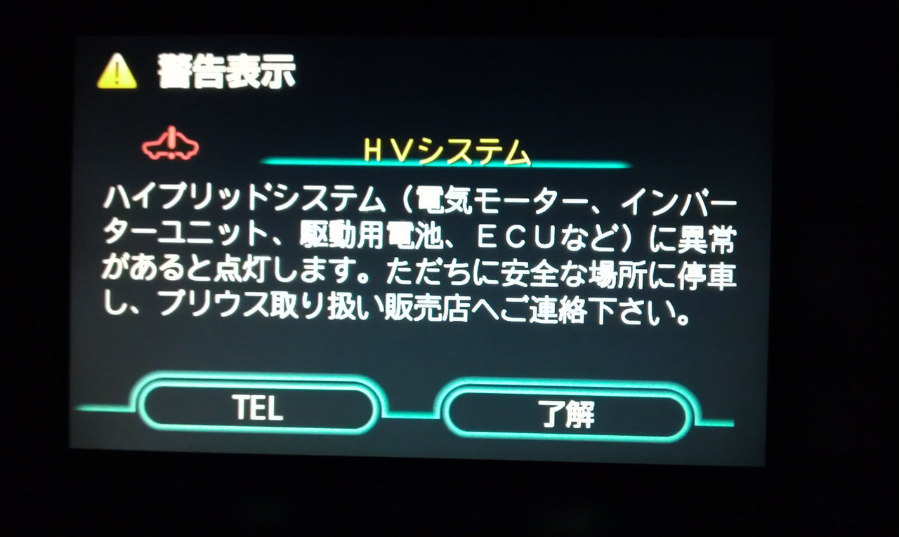

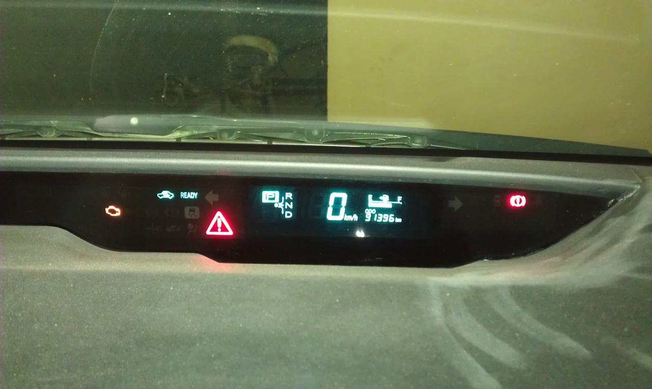

    I bought a toyota prius 2008 few weeks back. have done only 2500 km. Today I received few warning lights on the dash of my car. I need help what it may mean. I am attaching images for any help.
    On pressing details the following information is shown in japanese.
    I was only a km away so I drove it back home and tried restarting it after 3-4 hours and it showed the same problems. Please note I havent changed oil/filter etc since my Japanese exporter said they have changed it at their end.
    I live in Pakistan and hybrid cars arent formally launched here. So I doubt there will be any help available. when my car is off, it shows a blinking signal (in red) of an image of a car with a wrench picture, any help would be highly appreciated. thanks

    The light on the right side means your tire pressure is low on one or more tires. Otherwise you have some kind of "check engine" alarm. You can buy an OBDII code reader from a variety of sources online, sometimes as low as $25. It plugs into a standard connector just under the dash. All US cars since maybe 1996 have the connector, so most any decent car repair shop could read them. The OBDII reader will also reset the alarm. Amazon.com: Autel MaxiScan MS300 CAN Diagnostic Scan Tool for OBDII Vehicles: Automotive

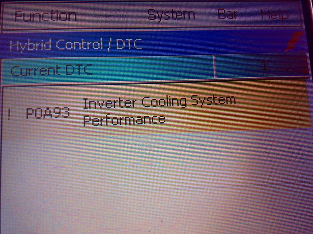

    edthefox5: Thanks for the detailed suggestions - can only get voltmeter tomorrow - but I did check it through Prius diagnostic tool and my aux battery was showing 12.4v - So I guess battery is fine. Problem seems to be in coolant side - there was hardly any coolant left in the white box - i filled some coolant in it and still the lights were displayed - there isnt any turbulance in the coolant and I guess the problem is with the inverter pump. I'll get it confirmed in a day or two.
    PriusCamper: thanks for your message - there was a 3 day holiday here so I am not able to go to any dealership till tomorrow. but knowing error codes can be read by the tool used for other cars - I would be able to isolate the problem soon.
    rjparker: thanks but the signal on right was because of footbrake/old handbrake. buying the scan tool seems like a good option. will that soon.

    Thanks Patrick Wong : I finally found that my coolant wasnt empty as I used only quarter of fluid to fill it up. Anyhow I got the error code from Toyota dealer here - i am attaching the picture for reference - it seems THE famous P0A93 - Inverter Cooling System performance error
    I have yet to obtain the sub-code which might take till Monday. Meanwhile I found the following helpful link/pdf explaining how to proceed with this problem.
    Let me ask few dumb questions -
    1- although it says Inverter Cooling System Performance error - people on internet have compounded it with failure of INVERTER (which costs too much) - My car still works fine and i drove it to the dealership - can I still have inverter problem ?

    P.S: My car shows the exclamation marks with triangle and car shape even when I start it after 8-10 hours.

    1. If your car drives OK after the powertrain has cooled down, then it seems likely that the inverter and transaxle are both OK.
