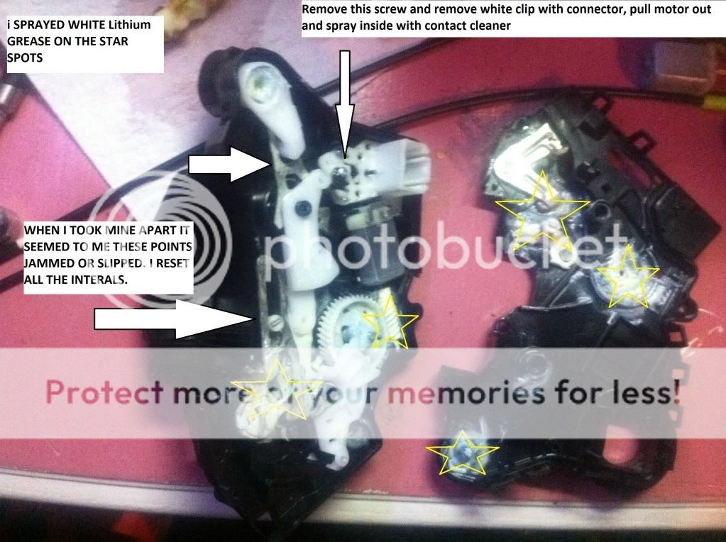

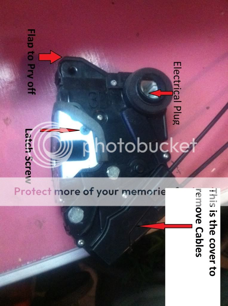

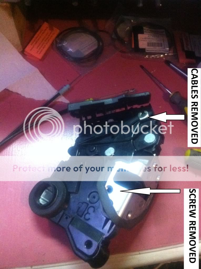

    So I took out the drivers side door lock actuator, cleaned it up, put some more grease on it, and it started to work again! Im going to try it with the other three![​IMG]

    awesome, I've encountered this problem on half a dozen toyotas, can you please repost the picture and use a program like Paint to circle all the areas you put grease on, and what type of grease did you use?
    you probably already put the door panel back on, if not can you post more pictures, if you did put the door panel back on can you give us a play by play instructions on exactly what you did? thanks

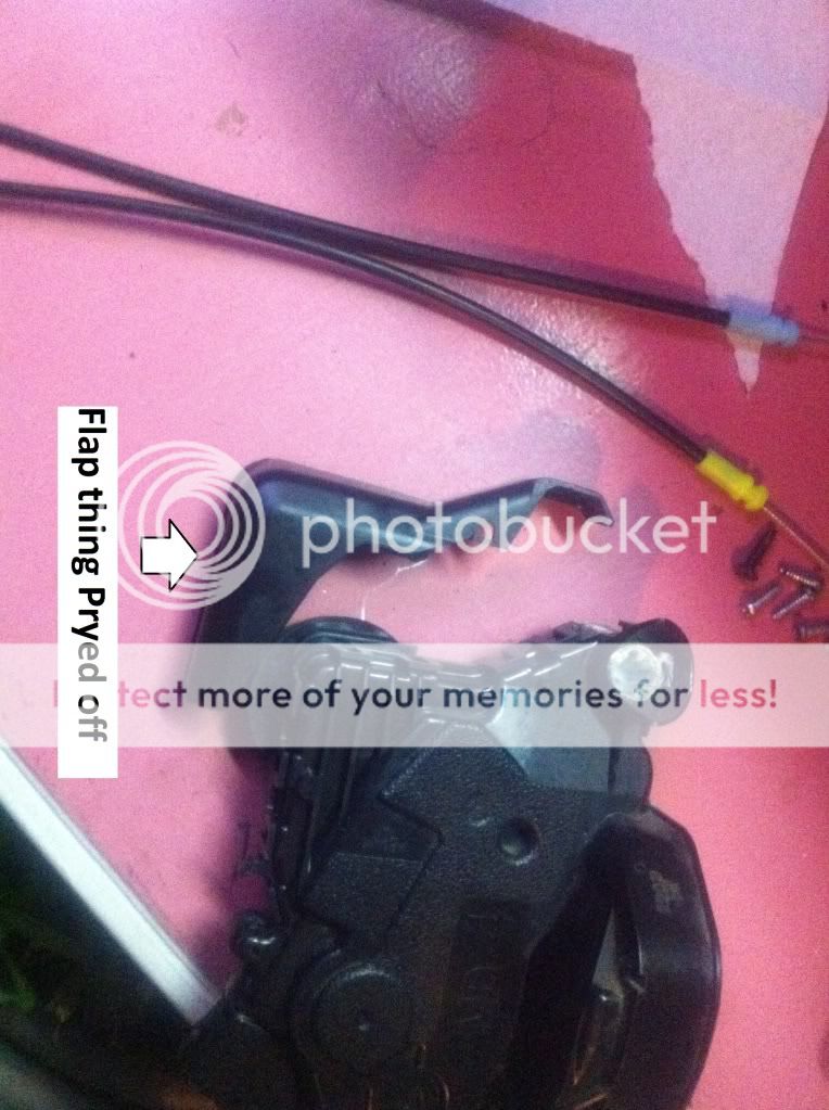

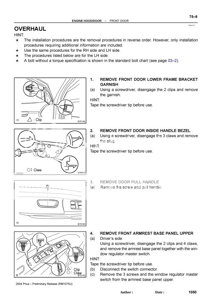

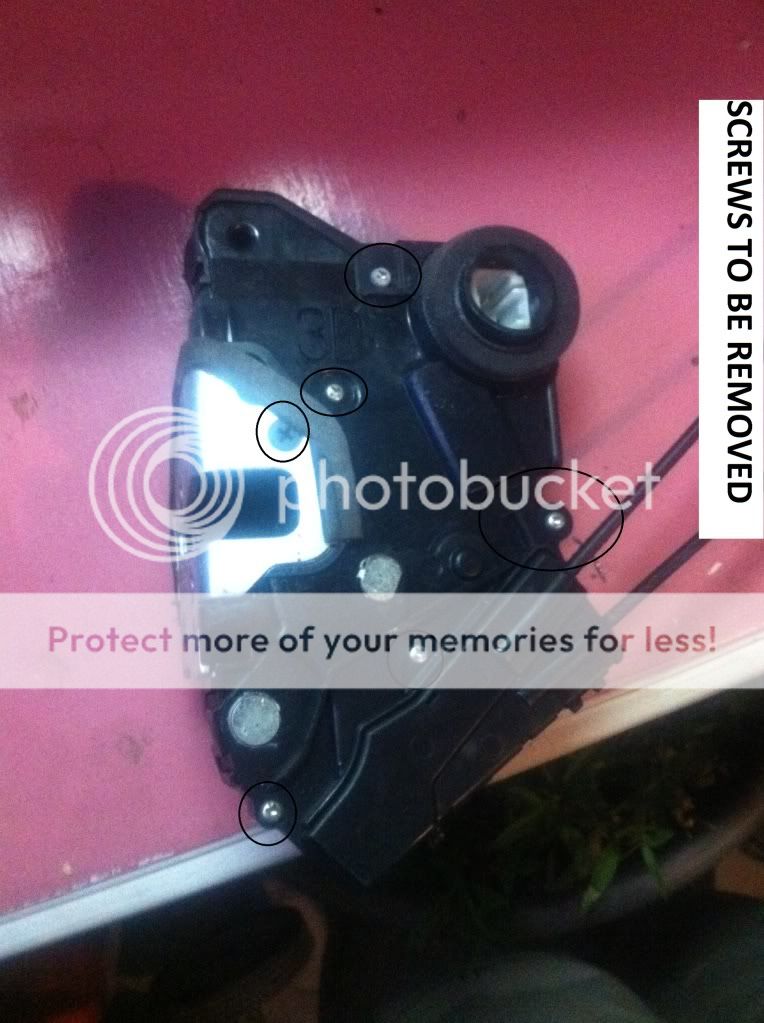

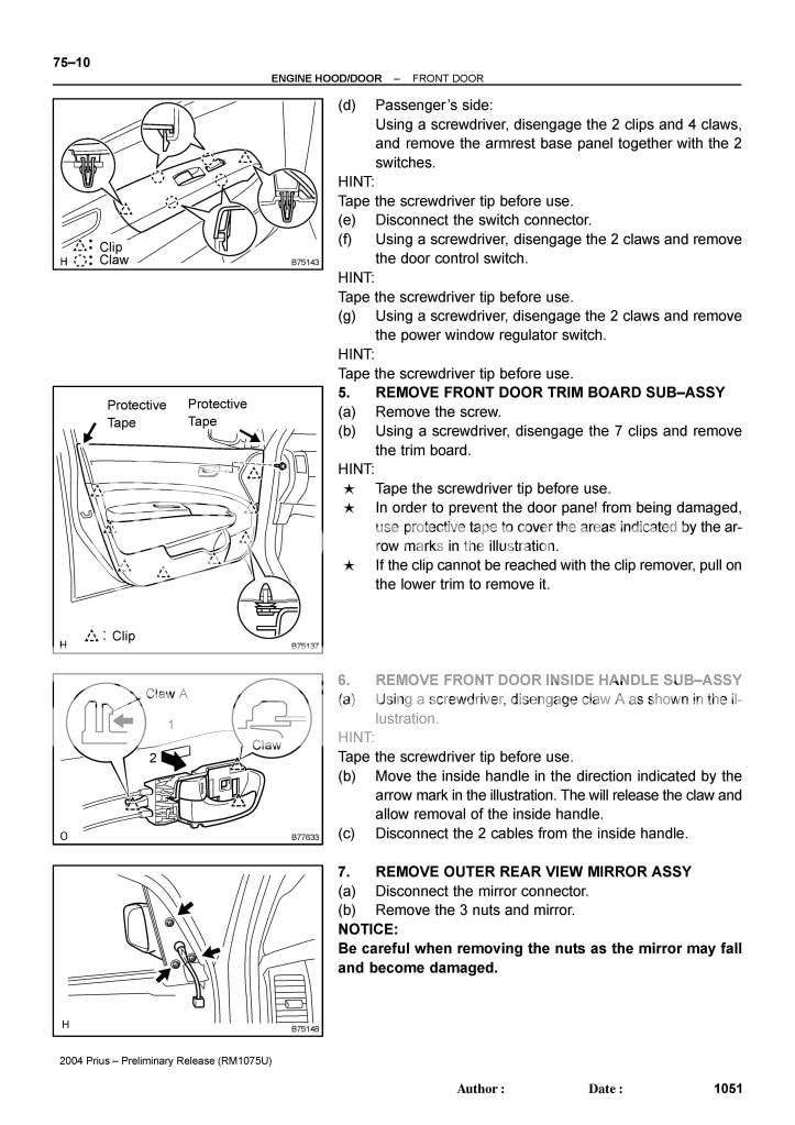

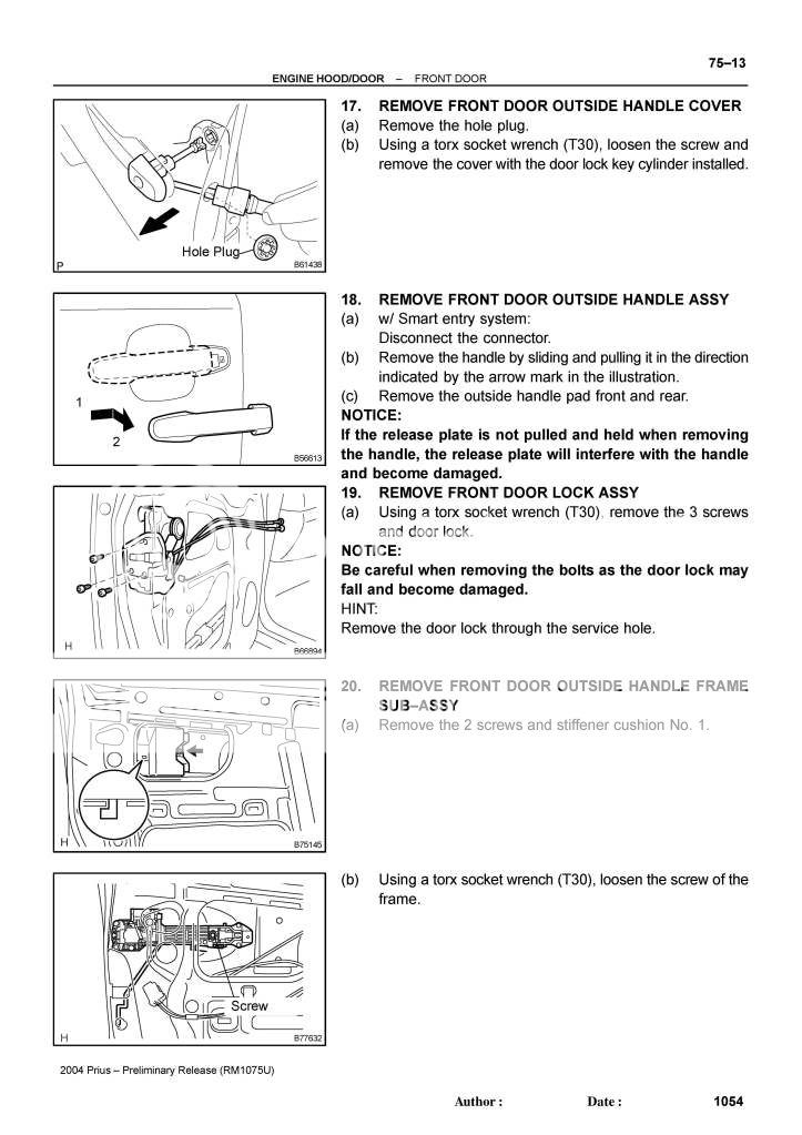

    The service Manual Tells the story of getting it out. I added some pics of what I did once I got it out. I forgot to mention I think it was jammed as well. I rest all the internals and made sure they were operating before I put it back together. Questions.....
    So now its Out!
    The Fix! That worked for me!
