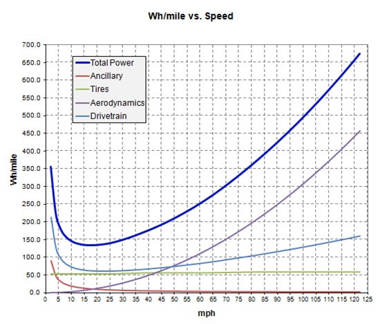

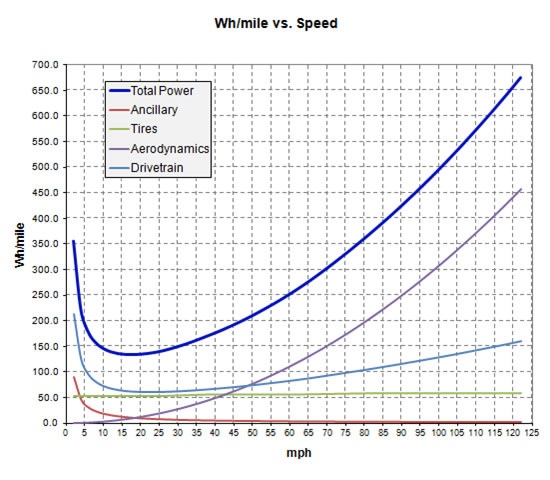

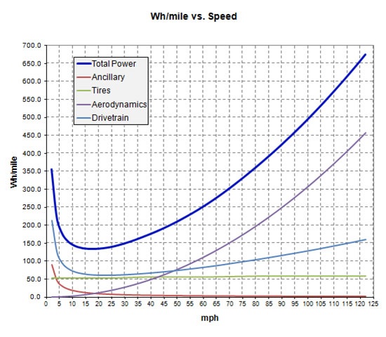

    Does this help? The data is for a Tesla Roadster. However, I at load speeds I assume little difference in Wh consumed between different vehicles. The data suggests the best strategy is to accelerate quickly to 15 mph.

    This graph seems a little optimistic for the Prius perhaps by a factor of 2. It certainly gives a good idea of how miles/kWh varies with speed.
    Prius battery 4.4 kWh
    Usable SOC range 20% to 85%
    Usable kWh 0.65 * 4.4 = 2.89 kWh
    From the graph
    135 Wh/mi at 20mph >> 2.89*1000/135 = 21.4 miles at 20mph
    175 Wh/mi at 40mph >> 2.89*1000/175 = 16.5 miles at 40mph
    250 Wh/mi at 60mph >> 2.89*1000/250 = 11.6 miles at 60mph
