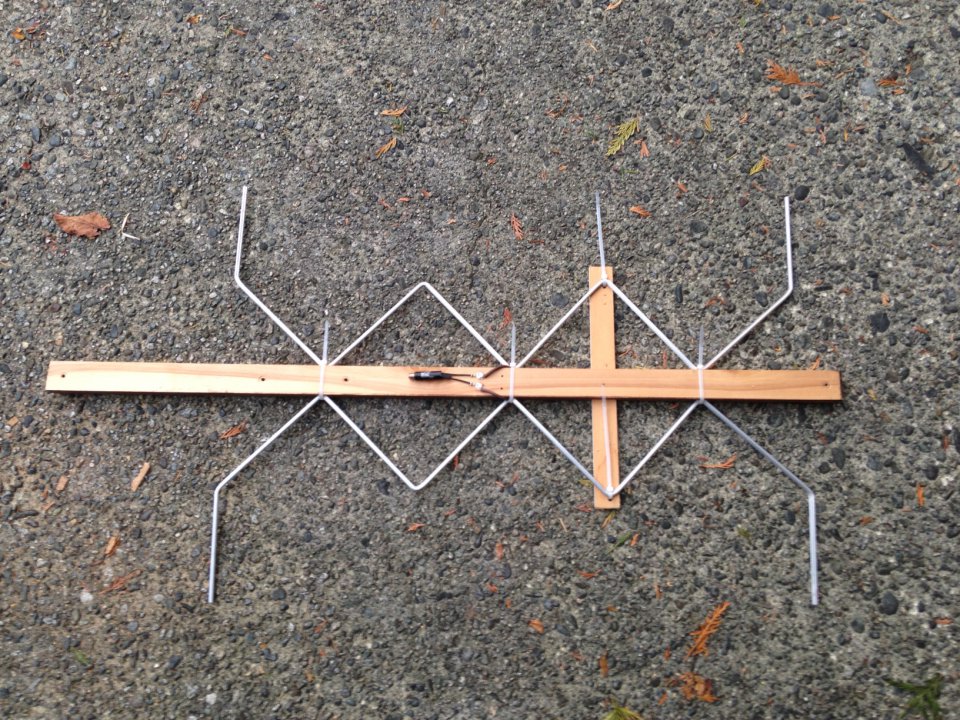

    And here's the Grey-Hoverman antenna I made up. It's an adaption of the one in the first link above. I had some scrap aluminum rods from some old vertical venetian blinds. Was meaning to take it to the recyclers, but it came in handy. The hardwood center piece was from a crappy old upholstered couch I demolished some years back. And the zip ties and the resister thingy were kicking around in my electrical carton.
    The cross piece is recessed in, to keep from skewing the rods. The space between the rods is quite critical, according to the instruction. I just lucked out with that 1.5" wide piece of hardwood. Also, I dimpled the hardwood along the edges, where the rods land, to keep them stabilized. There's short runs of appliance wire from the middle of the rods to the screws. I did trim the zip ties later. ;)
    You might want to try the rudimentary "coat hanger" aerial in the first DIY antenna link, first. It's very quick to make, and will be an eye opener. For me it pulled in about 3 channels, then the one above yielded eight. You just run coax from that resister thingy to the set.

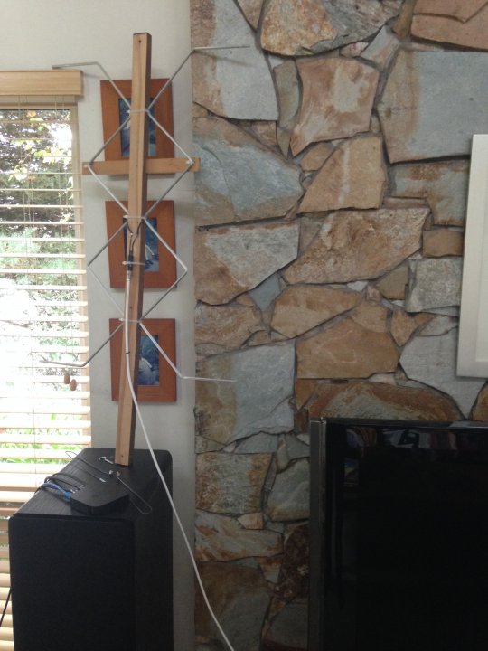

    Any "outdoor" antenna can still be used indoors. In the living space (funky but who cares) or in an attic if practical. I hooked ours up to a LONG coax cable and wandered around various upstairs bedrooms with no improvement, often worse. Maybe due to longer coax??
    Here's where it ended up, tv's in lower right third of pic, very convenient.
    (Hmm, ability to post pics with iphone appears to be broken. Bear with me...)
    Ok, here we go, I hope:

    Long line means more signal loss in the line, which may interfere with finding the best location. And some types of coax are lossier than others, e.g. RG-59 has more loss than RG-6.
