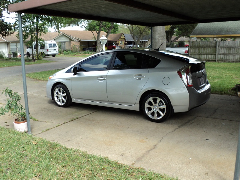

    Nice wheels.
    alekska and dorunron like this.
