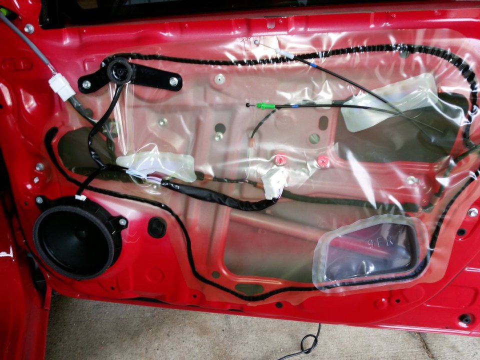

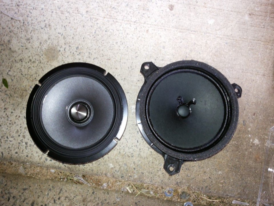

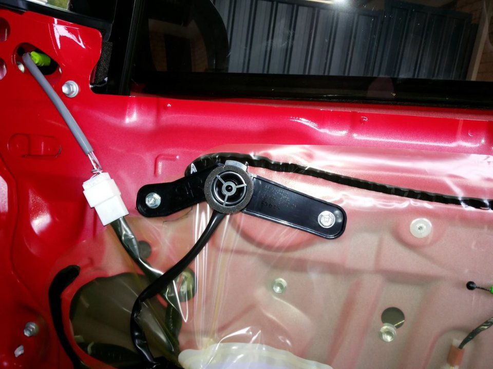

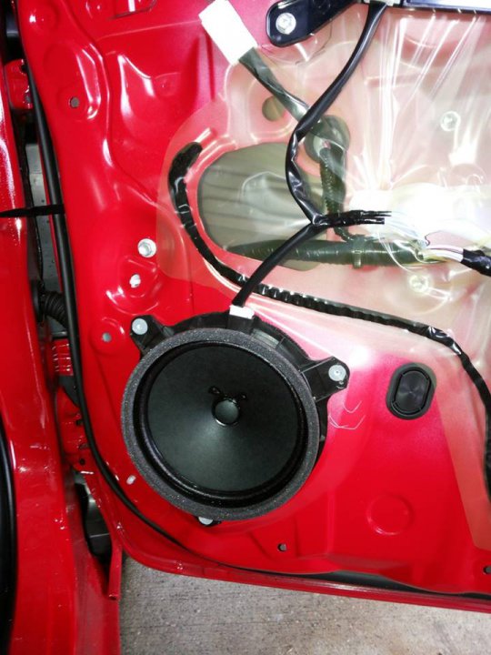

    Hello, I loved this Forum, I wanted to change my factory stereo, I would have failed if I did not find the information on this forum. Since I found and used so much information, from this forum, I decided to post what I did.
    Pioneer 3500 dab head unit
    Alpine SPR-60 rear doors
    Alpine SPR-60C front doors, split component.
    JL 6*9 RE690-TXi Rear parcel shelf, wired to amp
    JL 12 inch Sub
    JL 5 channel amp XD700/5
    Installing the alpine tweeter in the front doors was easy, just cut the door trim around where the factory mesh was, it bolted in perfect.
    The sound is loud at 11 and clear, I am impressed, perhaps too loud. Some people have been telling me to enter it into a competition, not sure about doing that sought of thing though.

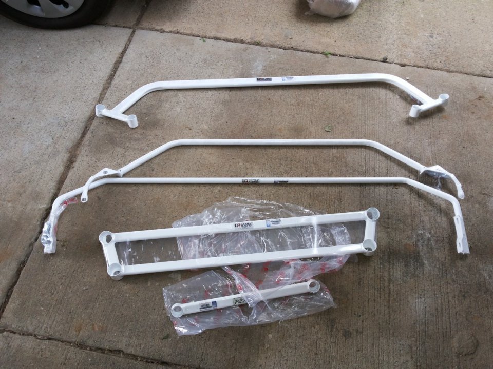

    Also upgraded the suspension so it would handle alpinefactorystereo.jpg Factorydoor.jpg factorydoor2.jpg factorytweeter.jpg

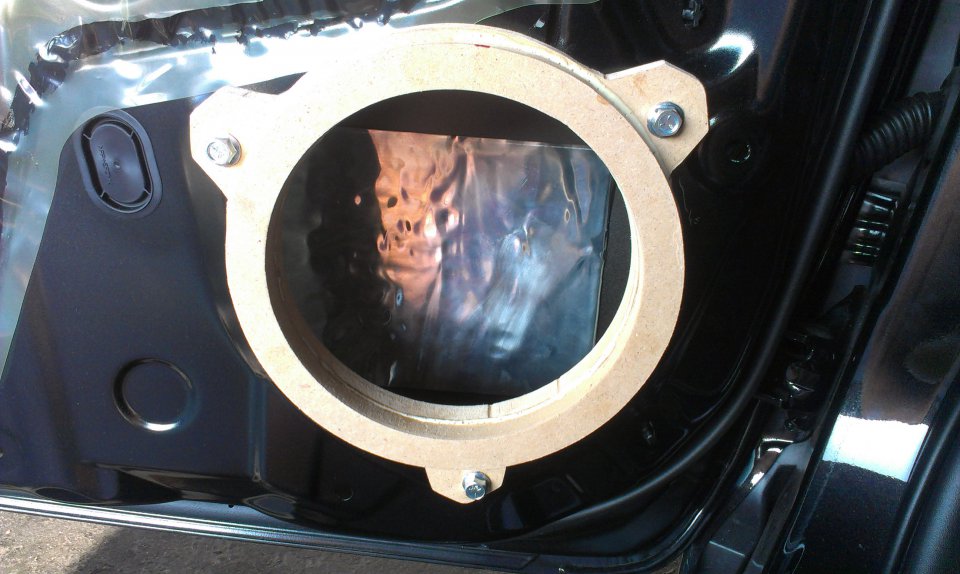

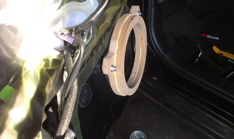

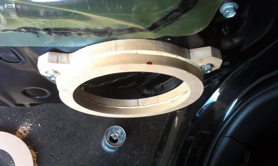

    some photos of the spacers i needed for the front doors. i needed 1" to clear the window when rolled down. i only needed 1/2" to clear the back window.
    i test fit them yesterday, i'll be waterproofing them today.
  11. B2FiNiTY
    B2FiNiTY Active Member
    Dec 17, 2012
    979
    227
    wow, that's a huge spacer. will the door panel still fit?

  14. los panda
    los panda Member
    Jun 23, 2013
    155
    yes, it did, i was relieved.

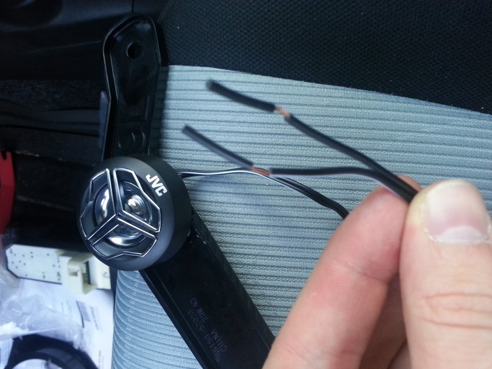

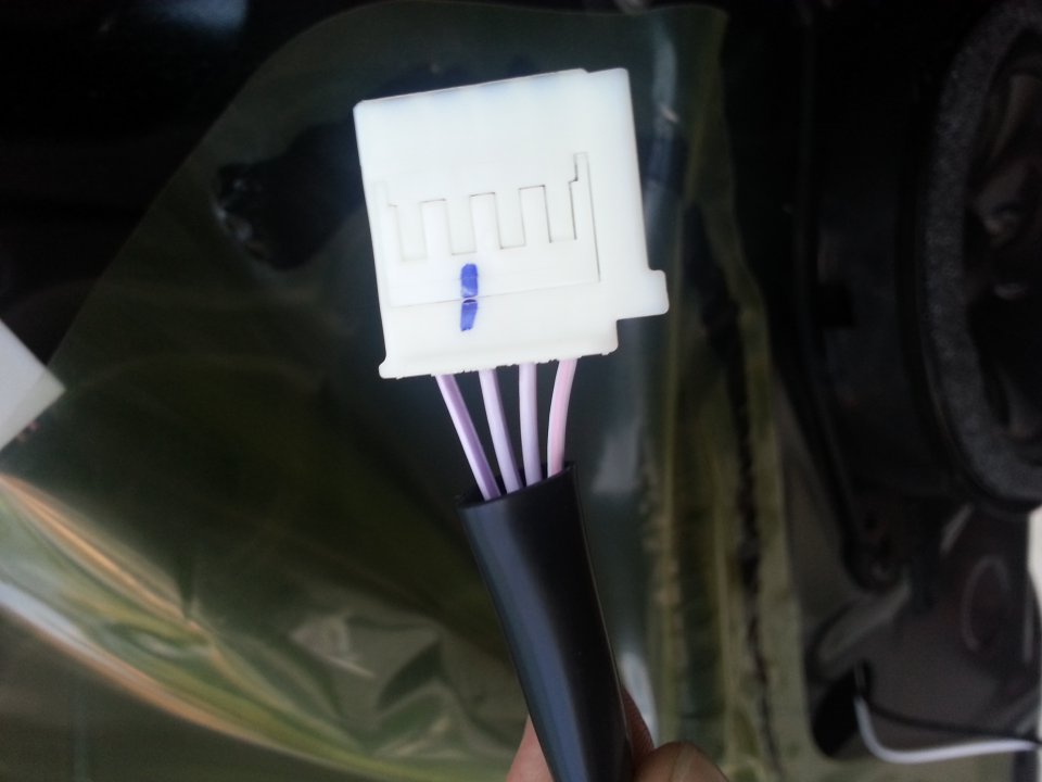

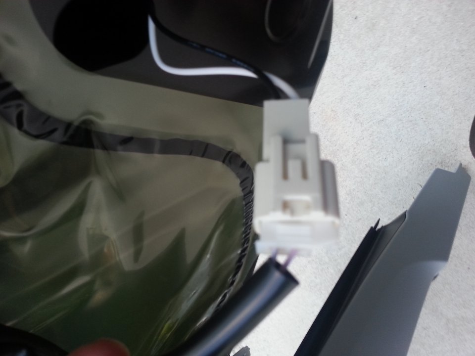

    San Diego
    Did you figure out how to wire the 2 wired after market tweeter into the 4 wired harness for the OEM tweeter? I'm at the same crossroads and am at a loss.
    [Edit] I figured it out, you simply splice the two lighter colored wires together as one Positive, and the two darker colored wires together as the Negative. I forget the exact colors right now. But I ended up upgrading my stock speakers that included tweeters in the middle, so the stock tweeters were redundant and i just disconnected em.
