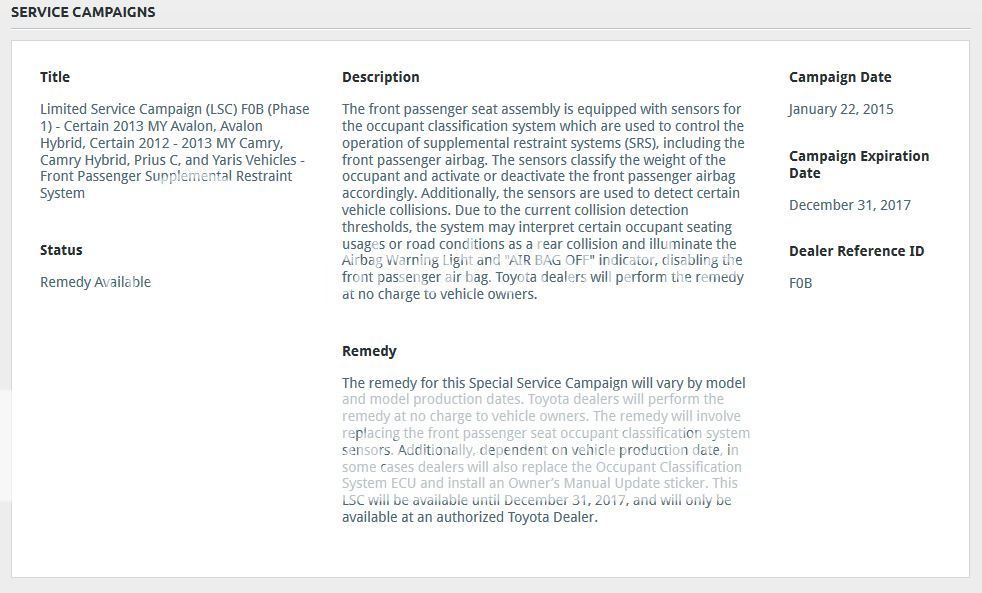

    Received my letter in the mail last night to replace the passenger side SRS seat sensor and possibly the SRS CPU.
    I've not had any issues with my SRS system so should I skip the repair?

    Ha. What I meant to imply was that it seems the recall has something to do with light people not weighing enough to activate the airbag, right?

    Does the front passenger seat need to be removed to make this repair?
  14. PriusInParadise
    May 24, 2012
    180
    91
    Hawaii
    Yes, the front passenger seat will be removed and partially disassembled for this repair.
    The Occupant Classification System (OCS) weight sensors on the seat frame will be replaced.
    On some vehicles, the OCS ECU will also be replaced, and an Owner's Manual insert will be installed.
    After reassembling and reinstalling the front passenger seat, OCS system calibration will be performed.
