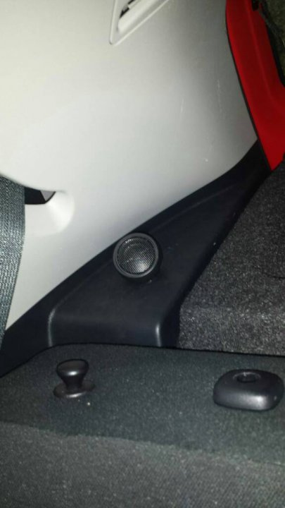

    5) In the rear of the C there are two small shelves on either side of the cover for the back storage area. These made a great location to put the rear tweeters using the angled tweeter mounts that came with the speakers.

    can you post pics of the tweeters in the rear?

    This is a pic of the tweeter on one side. Kinda hard to get both in one shot.

    Is that tweeter behind the rear seat? The imaging has got to be horrible.....

    not where i would have installed the tweeters, but the op is obviously very happy w the sound.
