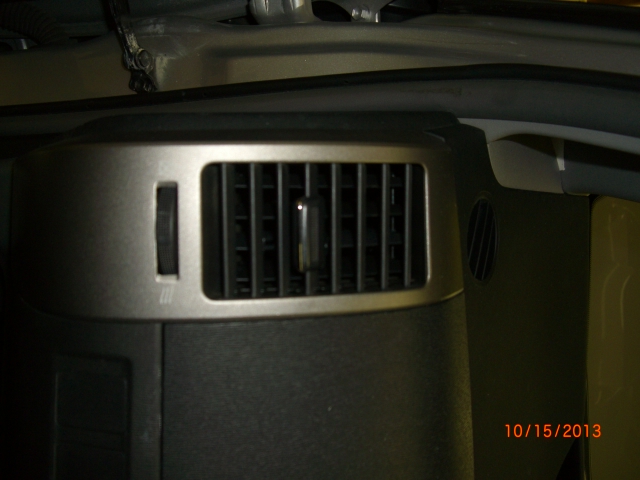

    Its awesome you fixed the rattle...I have a 2008 prius with the same issue. Can you send me a pic of the "silver thing with the round barrel knob to operate the flapper that controls air flow" Also, where can one buy the silicone grease from..and where exactly did you apply??

    [​IMG]agrahul11.
    Here is a picture of the area in question which is the left side heater/ac vent assembly at the upper left hand side of the dash. The picture is sideways but if you look carefully, you'll see the round black knob on the bottom and as you rotate it, it'll control the amount of air coming out of the vent. Once you remove this silver vent assembly from the dash by grabbing the top and bottom and wiggling it while pulling straight out, you'll see that as you rotate the above mentioned round black knob, a plastic arm is connected to it and also is connected to another black plastic arm. It's this connection that I found was rattling. What to do? Couldn't glue it together nor immobilize it so I elected to put some very heavy, sticky CarQuest Silicone Brake Lubricant at this juncture and all was well after that. I must admit that this noise wasn't necessarily always present prior to the fix and occasionally it still sounds like it wants to start up a bit but after I rotate the round black knob again, the noise is gone for a very long while. Good luck with the fix.
