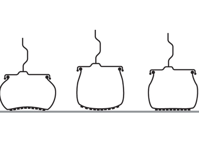

  16. JimboPalmer
    JimboPalmer
    Expand Collapse
    Tsar of all the Rushers, Nadir of Wrongness
    Apr 14, 2009
    8,653
    2,695
    Greenwood MS USA
    The better the tread sits flat on the road, the better for safety. That it also has better MPG than Toyota's choice, is just a perk.

  18. Insight-I Owner
    Insight-I Owner
    Expand Collapse
    2006 Insight-I MT + 2011 Prius
    Aug 29, 2009
    505
    96
    Essex, CT
    The problem with this sketch is that it misrepresents both the design and actual behavior of modern tires. Looking at the cross-section of a real tire , you can see that the tread area is far thicker than the sidewalls. And the tread area is stiffened by circumferential steel belts. At a 'normal" inflation pressure, the sidewalls bulge near the contact patch. At higher or lower pressures they bulge a bit less or more, though the difference can be hard to see. IOW, higher pressures are taken up by reducing the bulge in the sidewall, not by deforming the contact patch as depicted here.
    Lots of useful info in the Inflation Pressure section here:
    Tire - Wikipedia, the free encyclopedia
    "Modern tire designs allow for minimal tire contact surface deformity during high pressures, and as a result the traditional wear on the center of the tire due to reasonably high pressures is only known to very old or poorly designed tires."
    "Many individuals have maintained their tire pressures at the maximum side wall printed value (inflated when cold) for the entire lifetime of the tire, with perfect wear until the end. This may be of negative economic value to the rubber and tire companies, as high tire pressures decrease wear, and minimize side wall blow outs."
    "During the early stages of tire engineering, and with current basic tires, the tire contact patch is readily reduced by both over-and-under inflation. {With these tires] over-inflation may increase the wear on the center contact patch, and under-inflation will cause a concave tread, resulting in less center contact. Most modern tires will wear evenly at very high tire pressures, but will degrade prematurely due to low (or even standard) pressures. An increased tire pressure has many benefits, including decreased rolling resistance. It has been found, that an increased tire pressure almost exclusively results in shorter stopping distances, except in some circumstances that may be attributed to the low sample size."
    I don't think there is "a pressure that will yield best mpg": as one increases pressure further and further above the sidewall rating, mpg will continue to improve but the improvements will get smaller and smaller as the pressure gets higher.
