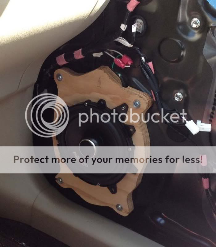

    I just did mine, front only. I put in Polk, 6-1/2 rounds. I have another set for the read doors. Much better sound. I have to use a bit more volume but its fine. The wood is a bit crude for now, I will correct it next week when I do the rears.

    I took out the speaker from the door, traced out the pattern on the plywood, then the mounting holes, then trial and error on the patteren till it fit right, 10-32 screws and nuts to hold the wood to door. Traced out the speaker pattern on wood, cut it out, I used a sabre/scroll saw, handheld, all done freehand.

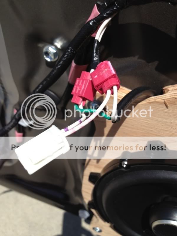

    Here is how I did the speaker wiring.
