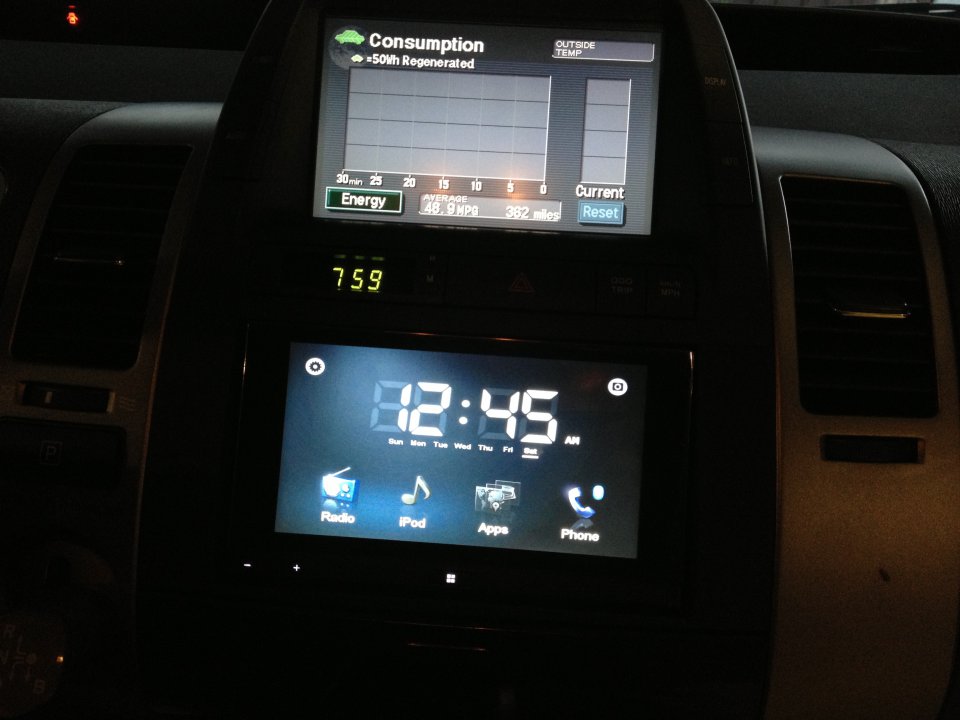

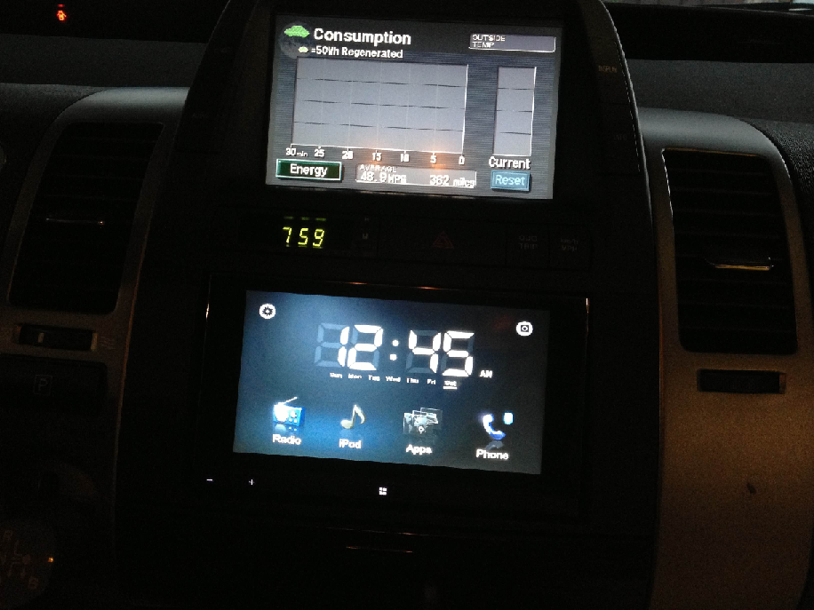

    This can be done! Just got mine back. It's a snug fit, but worth the congestion to have the same appradio I had in my civic hybrid. It took a while to find someone willing to take on the project but I'm thrilled with the results.

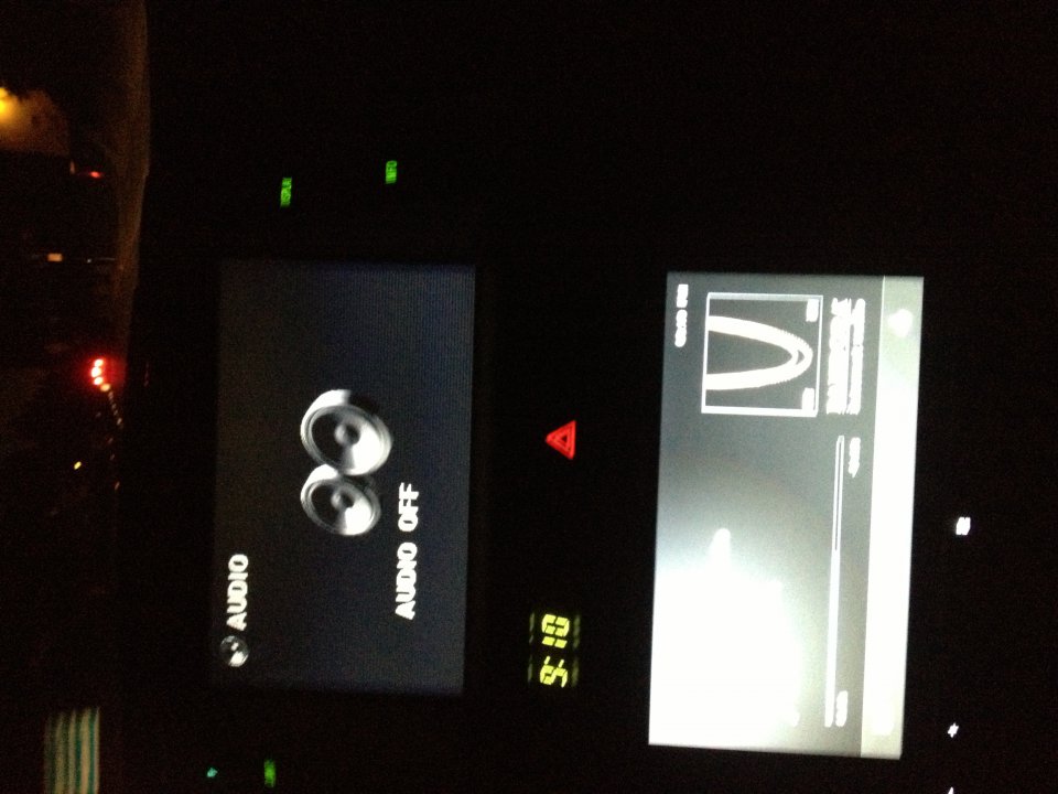

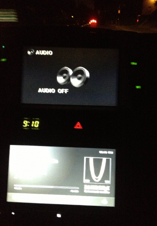

    Posted from my mobile... not sure why one posted sideways - here it is again, right side up:
    Audio controls do not function (same as single din aftermarket upgrade) and will always display as "audio off"
    $80 for the steering wheel control adapter
    ac still functions

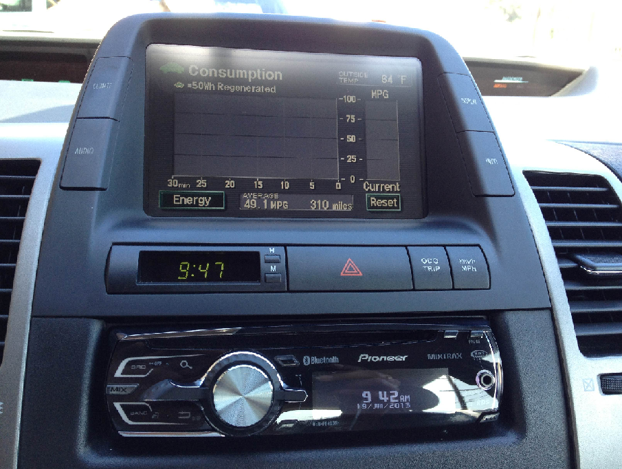

    and, the "before" shot with a single din:
