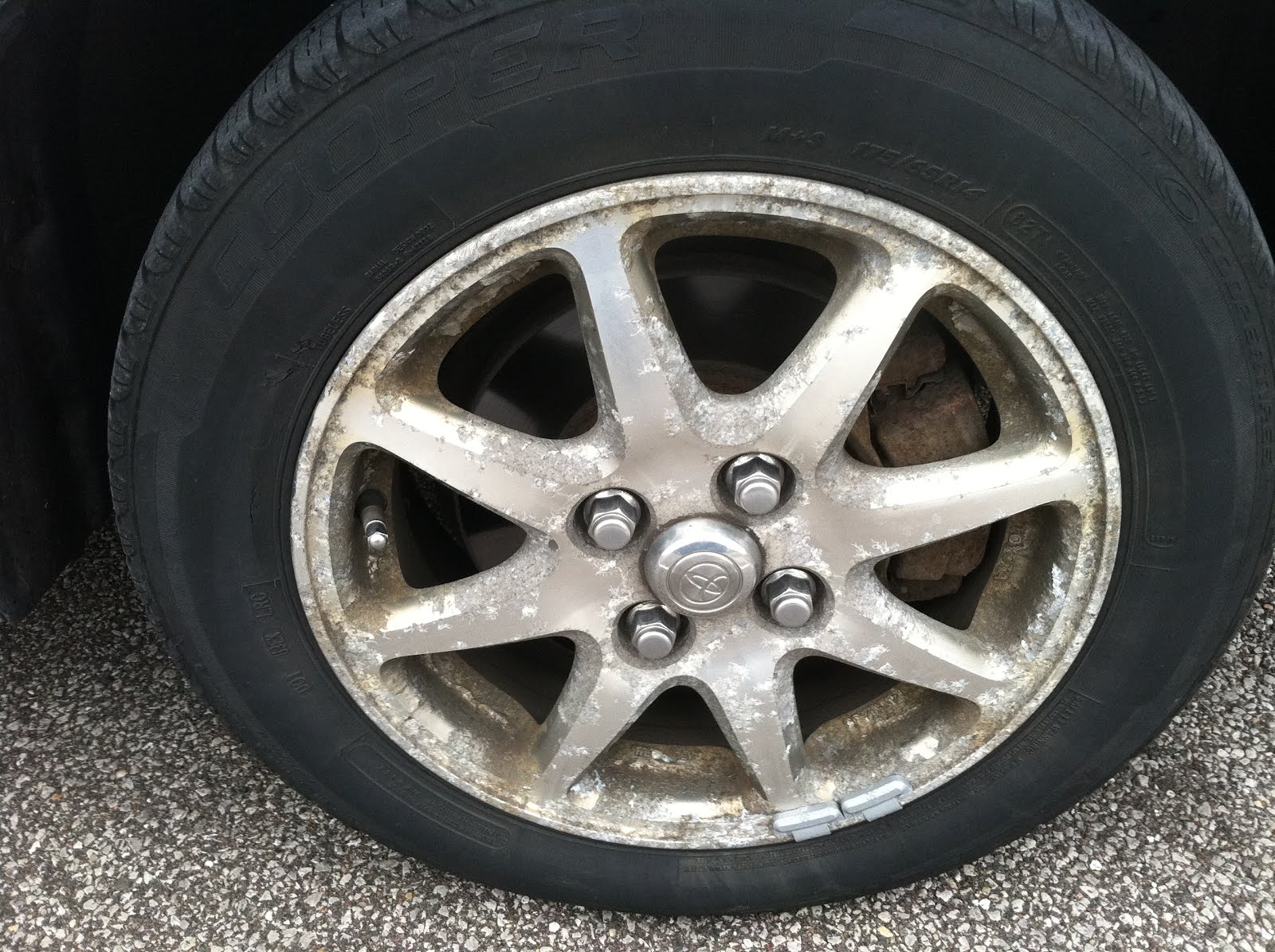

    Any recommendations anyone can give on restoring these wheels corroded from either ten years of driving in the snow (or someone screwing them up trying to remove salt/road stuff from ten years in the snow).
    I'm a newbie- didnt know if it was okay to replace them with a cheap aftermarket wheel at a tire warehouse?[​IMG]

    I don't think they are worth restoring because nice wheels can be purchased fairly cheap ($200-$600). The cost of trying to restore them could be greater.
    Look for used Prius wheels as replacements. Wheels from an GenII or GenIII (2004-2012) will fit. The 2012 black wheels sell for around $200-$500 with tires! Check eBay as well. The GenII 15" wheels are cheap.

    I just noticed that the wheel pictured is a 14" wheel. Do you own a classic Prius (2000-2003)?

    I figured when I saw the 4 lugs. So disregard my earlier advice about used 2004-2012 wheels as they will not fit your car. If you can find a nice set from a wheel store you can use those. Just make sure the width and offset are as close as possible to the factory numbers.

    Just to let you know, I have attempted to restore those wheels on 2 separate occasions. On both occasions, I finished one wheel and gave up. It is a lot of work and it is so hard to get to all the areas. Only the small wire brush for a Dremel tool can get to some of the places and they disentigrate very quickly. My advice is, just deal with what you got. You'll be a lot happier.

    Professional restoration places can blast the wheels with walnut shells and clean em up but it takes tire removal and remount and it isn't cheap. On another car 4 years ago $100 a wheel for an aluminum wheel and repaint. And yours would have to be sealed.
