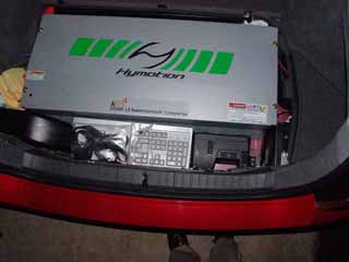

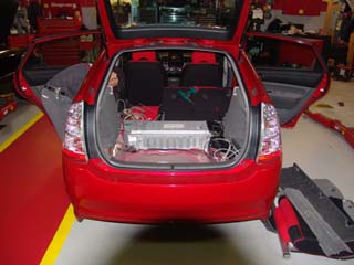

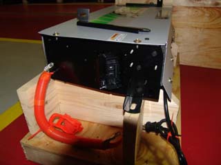

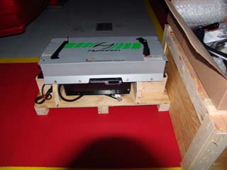

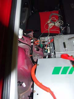

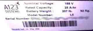

    Here is the battery.

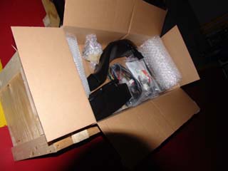

    Here is the contents of the parts box.

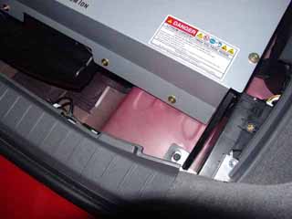

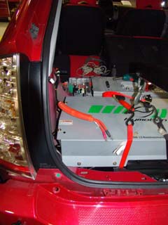

    Here is the side view of the battery where the high voltage lines come out.

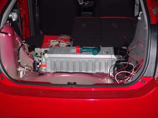

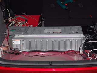

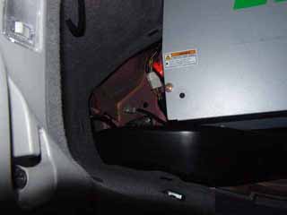

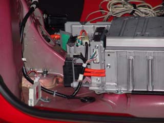

    Here is the wide shot of the stock battery.
    Close shot.

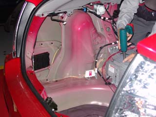

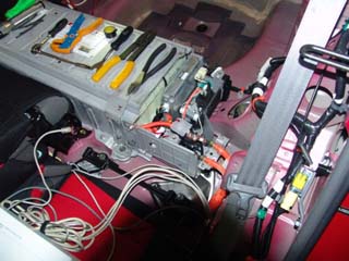

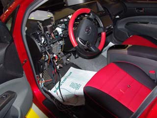

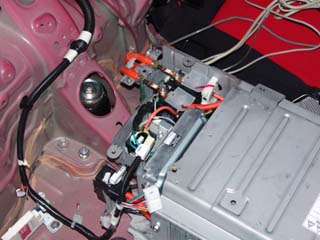

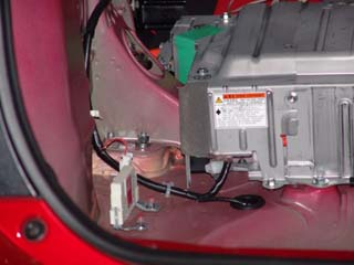

    Here is what the car looks like naked from the inside.
    Close up of the battery ECU area.
    Cover off
    Wide shot
    Close up

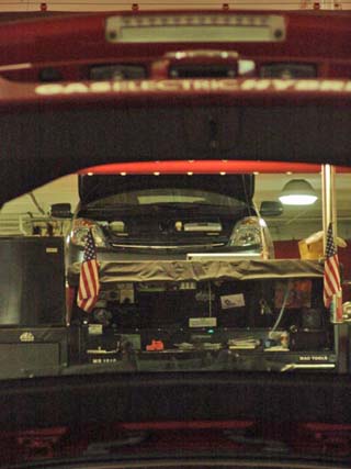

    Someone is a little curious of what’s happening on the other side of the service area. ;)
    Close up.

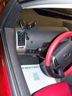

    Wiring for the switch and ECU.

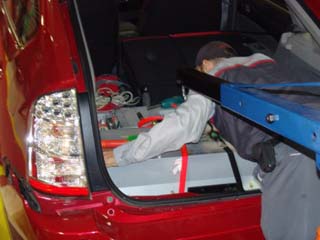

    Matt was able to place my switch above the "blanks" for me as I have all of my "blanks" filled up with buttons. :) Thanks Matt!

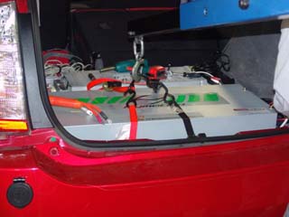

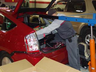

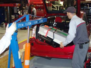

    Matt installing the battery
    Battery install
    Almost there

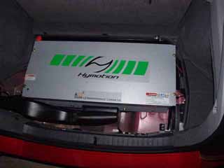

    Done
    Another view

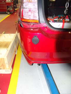

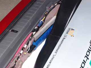

    The plug
    Wires
    Finished install

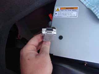

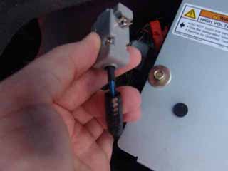

    Here is something interesting I found on the left hand side. It looks like a serial cable. It only has three wires that I can see. My guess is that it’s for updating the firmware or monitoring the battery. It would be nice to find out what it actually does.
    Here is the view of the wires.
    I have tested to see if it sends any information to my serial port on my computer but I did not see any information with the pack turned on or off. My guess would be that in order to get information from this connector you need to send it a request or this may just be for programming. It might be something like a JTAG.

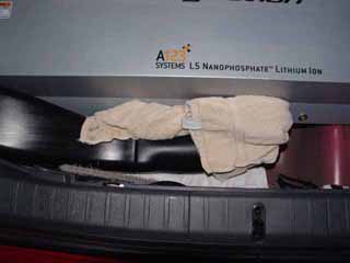

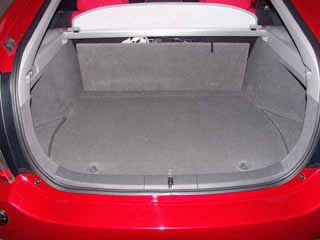

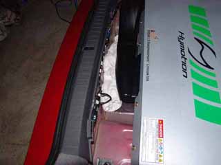

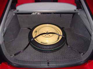

    As far as storage goes there is not much room for anything but with a little creativity I was able to fit almost all my crap back into the storage area. I should note that you should not block the airflow to the under side of the battery. The way I have my stuff laid out it should not block airflow but you have been warned.
    Here you can see there is a big space on the right hand side. Below the air duct there is a large gap where you can store stuff but it’s a tight fit to put things down there. I think the small gap below the battery is where the air intake is for the battery so you don't want to block it with a bunch of crap.
    There is not much room on the left hand side either because the exhaust duct.

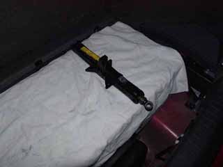

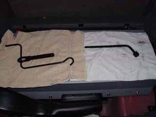

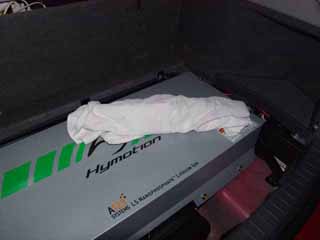

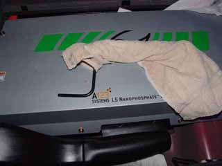

    What I did with the jack was to wrap it in a towel.
    All wrapped up.
    And I stuffed it partially below and in between the air duct. It fits nicely here and won’t rattle around.
    My ice chipper and snow brush fits nicely here.
    I wrapped up the crank / tow eye, and the lug remover. I fed the crank through the tow eye to keep them together.
    This is how a warped the crank and tow eye. I then lowered the crank in between the air duct and battery casing and the whole thing rests on top of the air duct. The lug remover fit nicely in between the stock battery and the Hymotion battery on the right hand side. You can see the towel in the upper right.
    Here is where the crank/tow eye fit.

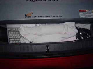

    I was able to pack a few towels in the left and I was able to fit my keyboard, and air compressor in this area.
    I also wrapped up some cans of deicing for winter.
    Everything hides away.
    All except the spare tire.
    I will remove the spare tire and carry a tire patch kit when I need the extra room in the trunk. Since I hardly ever carry a lot of stuff I will keep the tire in the back. If I need to carry something large I can either use the back seat or move the tire to the back seat if needed.

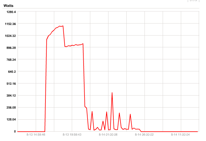

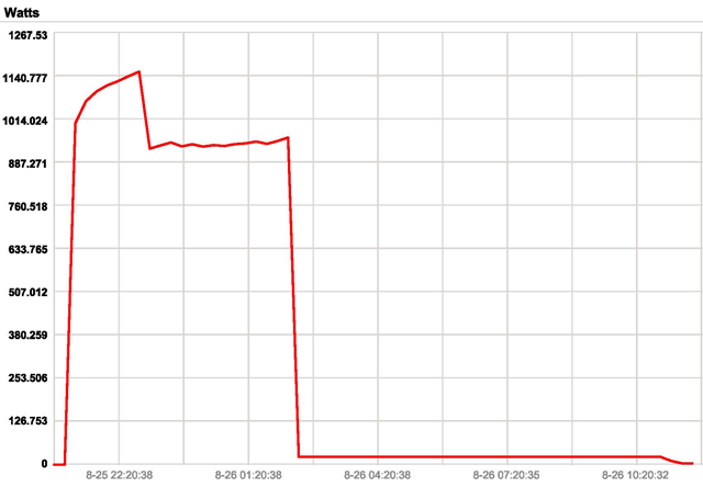

    Charging the pack seems to take about 5-6 hours. After charging it seems that the battery still draws about 22 watts and about .3 amps. My first observation on this lasted about 12 hours and when I was looking at the battery I heard a fan. So I think the fan is just cooling the batteries and the cooling period takes about 12 hours in the summer heat. In colder temperatures the cooling only lasts a few hours.
    I'm using a Watts Up? .Net meter to track my usage. Info about this product can be found here. http://www.wattsupmeters.com

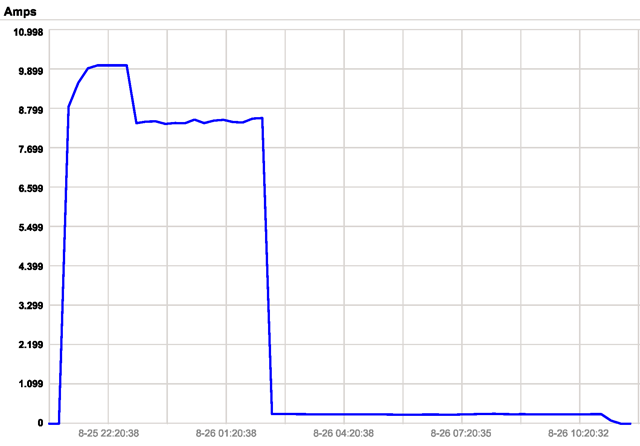

    Here is a graph of the watts used over time. This was my first charge from a depleted pack. The charge area is a period of about 11-12 hours. As you can see it spikes up to a little over 1kw then drops to about 900w to top off the batteries. Then it will linger around 22w with a few high spikes to cool the batteries.
    Here is a better graph of the charging process from a depleted pack. The first two hours the pack sucks down a little over 1000 watts and about 10 amps. Then the next three and a half hours it will suck down about 950 watts and 8.5 amps. Then the rest of the time it will suck down about 22.5 watts and .26 amps for cooling down the batteries. Once the cool down period is finished the amp draw is 0 according to my watts up? meter but it still shows about 3.5 watts being drawn.
    These two graphs represent about 12 hours of time.
    Watts
    Amps
    Charging the pack is very simple. Just plug it in and wait. The brake lights will come on to let you know you plugged it in and will dim to about %30 until the battery is fully charged then they turn off letting you know charging is complete. Here is a video of the charging in action.

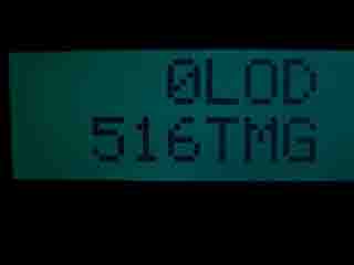

    I have noticed that when the Hymotion battery runs down to the blue bars the stock SOC will go all green sometimes but the stock battery holds a %60 charge. It’s kind of hard to tell the difference between the stock SOC and the Hymotion SOC sometimes but once you drive with the battery installed you get used to which one of the flickers is your Hymotion SOC and which one is your stock battery SOC. You can always disable the battery for a few seconds to get a view of the stock SOC. Sometimes when the pack is turned on and your on a different screen like the navigation screen it will not flip back to the energy screen. I have not determined when it will flip back to the energy screen and when it does not. It may have something to do with the SOC.
    Here is a video of the SOC flicker.
    [ame="http://video.google.com/videoplay?docid=8696490489659290367"]Hymotion State of Charge SOC flicker[/ame]
    I have also noted that with the engine being off more I may have to go with a year around grille block to keep the engine warm in city driving or do an coolant temp hack to keep the coolant temp around 160F. This way I can get into warp stealth sooner as well as get into a glide sooner. This type of hack will also let the car stay in full hybrid mode for longer periods of time when driving in the city.

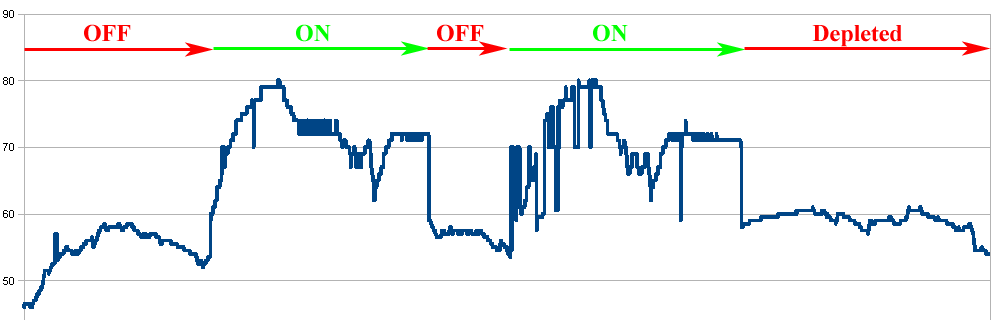

    It looks like if the stock Prius battery is around %59-%60 The Hymotion battery will keep the stock battery charged. If the SOC is below %59 it will not charge the stock battery unless the car is in motion. More testing is needed to see what is really going on.
    The ScanGauge may not be accurate to calculate fuel mileage because when in EV mode it still reports .01 GPH of fuel being burned. When getting numbers as high as 500MPG on a trip just sitting still for a few seconds will make it drop a few MPG. Even when in EV mode while moving it may not get very high very fast because of this. For an example if you driving down the road and the SG said 250MPG you might be closer to 275MPG or something.
    When the Hymotion battery starts to get down to the last 4Ah it starts to lower its spoofed SOC. While it’s lowering its SOC the stock Prius battery is also draining. For an example if the Hymotion battery is reporting %70 SOC then the Prius battery has about %60. If the Hymotion battery is reporting %65 SOC then the Prius battery would be at about %%55. If your in EV mode this can go as far down as %40 before the Prius kicks on the engine to recharge its stock battery. More testing is needed to really see what’s going on here.

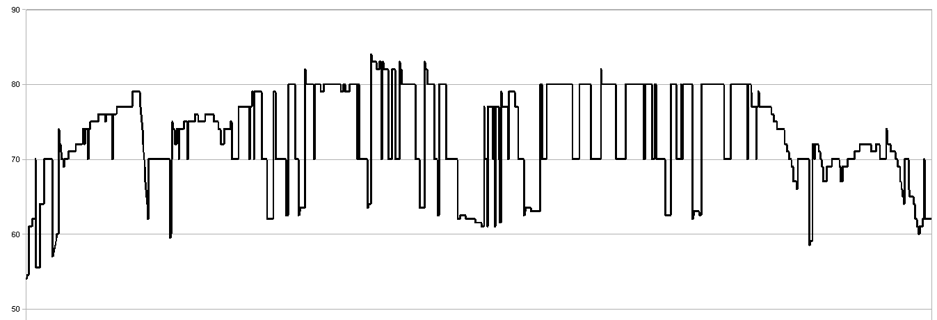

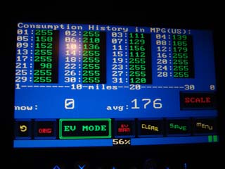

    Here is a graph of the reported SOC from my CAN-view. Data is captured about once every two seconds or so. This graph represents my whole 22 mile round trip commute.
    Here is a graph of the CAN-View reported SOC on a 60 mile round trip. I started the trip with the pack off because I wanted to use most of it on the highway. Then I turned it on until I got into the city then turned it off to do some P&G. Then turned it back on to go back home. Then the pack depleted and turned off the rest of the trip. My CAN-View said I used about 16.5Ah.

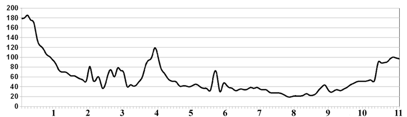

    My normal commute to work is about 11 miles one way or about 22 miles round trip. Most of my commute ( about %60 ) is 55mph speeds or slower when no one is behind me. Then the next %40 is all city driving. So according to the data from Hymotion I should be within the 30-40 mile range of the pack especially if I hypermile the heck out of it. I will always travel at the speed limit and not 1 MPH higher if someone is behind me. If weather conditions prevent me from traveling at the speed limit I will always travel at a safe speed.
    Here is my elevation profile for my commute to work. I was able to get the data from my hand held GPS and import it into a spread sheet to get the graphs. It was a little more accurate than the profiles you can create online. I still don't think it represents the actual elevation changes I encounter but its close enough. Since the roads here are next to hills the data that’s available online makes it look like I'm driving up and down mountains when in reality there are only a few minor elevation changes on my commute to work. The first 500 or so feet I can EV it out to the main road. Then its 55mph all the way to about mile 6.5 then it drops to 35 or below until I get to work. This profile elevation scale is not at sea level. Just add 500 feet to the scale and you will get the above sea level numbers.
    Here is a video of my round trip commute. The start of my commute to work is a little bit down hill. Then about 3 miles down the road there is a hill I have to climb. Once I get on the highway there is an overpass I have to climb and about .5 miles before I get to work I have to climb another small hill. Then reverse that on my way back home. In between the larger hills there are a few places that go up hill but don’t really affect my speed or MPG much.

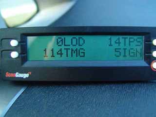

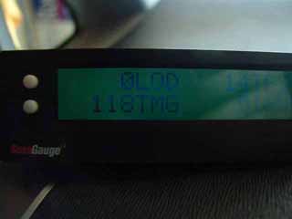

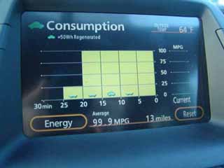

    For my first commute to work I decided not to use my EV button or any hypermiling tricks to see what kind of normal MPG I could expect. The only thing I used to improve MPG was my block heater. I stayed at or below the speed limit when possible. I mostly tried to stay at the speed limit. On my trip to work I pull in the parking lot with my ScanGauge showing 114MPG and 4 of my 5 minute bars were maxed out. The first bar was very low because I was setting up my computer to record some data. Normally when I just take off with my engine warm from the EBH I get over 50MPG the first 5min. On my way home my ScanGauge showed 118MPG. I still had plenty of charge left so I might try to use a little more EV mode if I can.
    To work SG
    To work MFD
    From work SG
    From work MFD

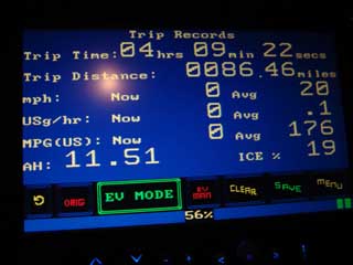

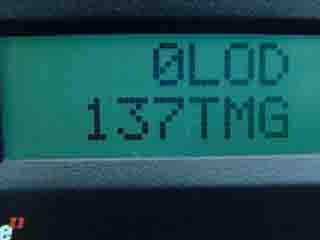

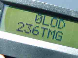

    Day two I was able to pull 137MPG and from what I learned from the pack I should have plenty of room for higher numbers. I should be able to do my entire city driving in EV mode and still have plenty of power for the highway in warp stealth on my normal commute. I was able to drive from work to a car show all on EV. I switch to EV when I started and did not let the car warm up. The total trip was about 5 miles. I did not get any good numbers for my trip home because I was playing with a few things and I forgot my pack was turned off. I was in EV mode and I drained the stock battery by accident. :( I still managed to pull about 90MPG though and had plenty to get a good 100+MPG even with that 5 mile EV only section.

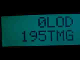

    Day three on my way to work I tried a little harder to keep the engine off and achieved 236MPG and I still have room for improvement. I started out in EV mode until I hit my 55mph road. Once on the road I got up to about 45 and tried to do a glide. The engine was still a little cold so I did not get into any kind of good glide but still better numbers than trying to keep speed. Once out on the highway the engine was warm enough and I was in warp stealth. I was drawing about 50A off the battery and holding 55 for the short distance to the overpass. Once getting to the overpass I had to use a little gas to keep from losing too much speed. Once at the top of the over pass it was all EV to the parking lot at work. I’m able to do that because after you come down off the overpass the speed drops to 50mph, then a short distance later it drops to 35mph, Then drops to 25mph, then raises to 35mph. Normally I could not hold a warp stealth from the top of the overpass to the 35mph zone but with this extra pack I can almost hold it forever. :D On my way home I was able to pull out 195MPG.
    Day four I pulled into the parking lot at work with 237 on the ScanGauge. I took a little detour to see if staying in EV mode a little longer would improve my MPG before getting on the highway. It looks like it will not help. On my way home I was lucky enough to not have anyone behind me and I was able to do 30MPH almost the way home. Someone got behind my on my last mile and I had to speed up. If it was not for that I could have had a 1000+MPG trip home. I pulled in the driveway with 516MPG.
    176MPG over 80 miles :D. Please note that my average speed includes time spent at stop lights and stop signs. Remember that if someone speeds at 80mph down the road they will still have a low average speed if part of the trip is traveled through a city.
    All but one of the 30 miles is three digits!! :D

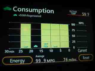

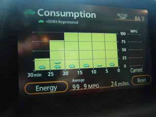

    For my highway test I started my stock SOC at %60 and I set cruise control to 55MPH. The Hymotion pack had a full charge and I did not turn it on until I set my cruise control, reset the trip B and reset my trip on my ScanGauge. The AC was off too. Once everything was set I turned on the pack. I used route 52 from Wheelersburg Ohio to about South Point Ohio where I turned around. I tried making elevation profiles but since the highway was next to the hills it looked like I was climbing 200 feet when I was actually on pretty level terrain with only slight elevation changes. Before I get to my results I have to tell you that about %75 of the trip was at 55MPH, %20 was at 45MPH or less due to construction and %5 was at a dead stop due to construction. Because of this and the GPH bug in the ScanGauge my total MPG at the end of the trip was a little low.
    The first 40 miles the pack was able to keep the car going at 100+MPG. When I reached the 40 mile mark the next 10 miles was 70+MPG. The pack quit with 50.7 miles showing on the trip B. If you recalculate it by taking out the construction zone and a little stop and go driving I believe I can estimate a total distance of about 55 miles with cruise control. My ScanGauge showed 101MPG but I can estimate it more in the 125MPG area because of the GPH bug. According to my CAN-View the pack Ah size was about 17.5Ah.
    So let’s review highway with cruise control set at 55mph.
    Actual Distance – 50.7
    Estimated Distance - 55 miles
    Actual MPG According to SG – 101MPG
    Estimated MPG Because of SGII GPH Bug - ~125MPG
    Estimated Pack Size – 17.5Ah
    Amount of Electricity to fully charge – 5541.2Wh

    Q. What does the dash button and light do?
    A. The button lets you turn the pack on or off. The light I think just lets you know there is juice in the pack and it can be used.
    Q. Can you disable the system and if so what type of steps are required to use the supplemental battery (just unplug and go)?
    A. Just turn the switch to the off position and the Prius will go back to normal operation.

    Thank you for sharing the pics. When you "sort it out" will you give a bit of a description for some of the photos? I'm curious about the various parts and the new holes and wiring you need to add to complete this mod.

    New pictures uploaded. Just use the link in my first post.
    Battery is in the car. :D
    I decided to leave the service center and head back to the hotel. They will keep the car overnight and I will pick it up in the morning. There is nothing else special to stay and take more pictures. All thats left is to put everything back together, charge and test it.

    Ignore that. That was my own installation of my scangauge. I may move it later. ScanGauge is not part of the Hymotion BREM although for $10,000 they should include one.

    Just wondering... Does the install/upgrade come with tire repair kit? It will be essential since you won't have the spare anymore.

    I know everyone has a thousand questions for you, but I am adding a few more to the list:
    1. What does the dash button and light do?
    2. Can you disable the system and if so what type of steps are required to use the supplemental battery (just unplug and go)?
    3. Is the charger for the batteries attached to the bottom of the unit (filling the spare tire area)?
    4. Did it come with an owners manuel, if so, could you scan and attach it to your next post?
    5. How do you know the SOC on the L5 battery pack?
    6. Does the vehicle sag from the additional weight, if so, do you plan to compensate for the additional weight?
