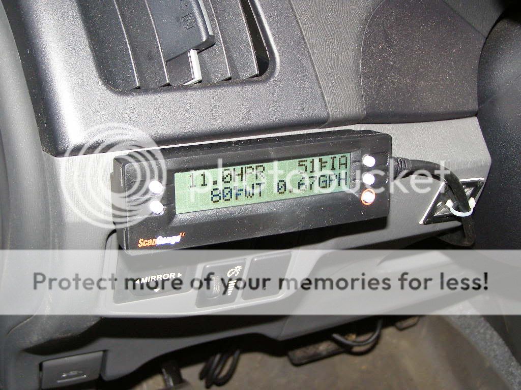

    A friend convinced me to block the grill and get a Scangauge. Got it at Amazon for about $130. My wife is pretty short, so sticking it on the dash above the steering wheel wasn't gonna work. So I put it here.
    I think that's a good spot. People with really long legs might bump it while getting in or out. I'm 6 foot tall and haven't hit it yet. Since the distance is pretty short from data port to Scangauge, I bundled most of the cable together with a piece of electrical tape and stuffed it underneath the console. You can see in the picture that the bundle slipped back out. It'll be simple to tape it in place if I have to.
    Right now I'm running water and intake air temps on the Scangauge's left column, which is more readily visible than the right side. Don't know what to choose for the other two parameters. Suggestions?

    Based on other opinions on this forum, I placed mine right above the steering wheel colum right behind the steering wheel. There is a flat shelf there.
    This puts the ScanGauge more in your line of sight and you do not have to take your eyes off of the road to read it.

    I find engine output in Kw, water temp, RPM and Amps most useful for me. The RPM and engine output in KW is helpful to gauge acceleration and cruising power. I use the amps when around town to provide insights regarding battery output to the electric motor and review charging level.
    I mounted the unit above the steering column as discussed in the previous post.

    I've got mine over the HSI display with its velcro attached to a black 3 inch binder metal clip. The binder clip is attach to the HSI display visor.

    OK, thanks, I'll have to look at the instructions to find the KW and amps displays.
    I haven't read the manual very thoroughly. My wife and I couldn't figure out why the display kept shutting off until I found the part about telling the ScanGauge it's monitoring a hybrid :) I still have to plug in the other stuff about engine size, etc.
    I'm pretty sure that mounting the ScanGauge just north of the steering wheel would partially block my wife's view of the HSI display, That's why I was casting about for options that wouldn't look amateurish, interfere with ingress/egress, keep falling off, etc.
    It's been very educational to watch the water temp. The grill is fully blocked with 1/2" foam tubing. Our commute is 14 miles, via country roads and a coupla small towns. The ICE finally approaches 190 deg. F about a mile or two from work. And we're not talking snowshoe weather here. Western Washington winter temps are fairly mild. January av. high is 44.5 deg., low is 31.6.
