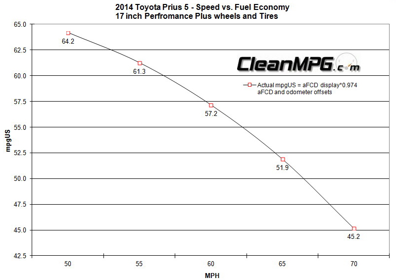

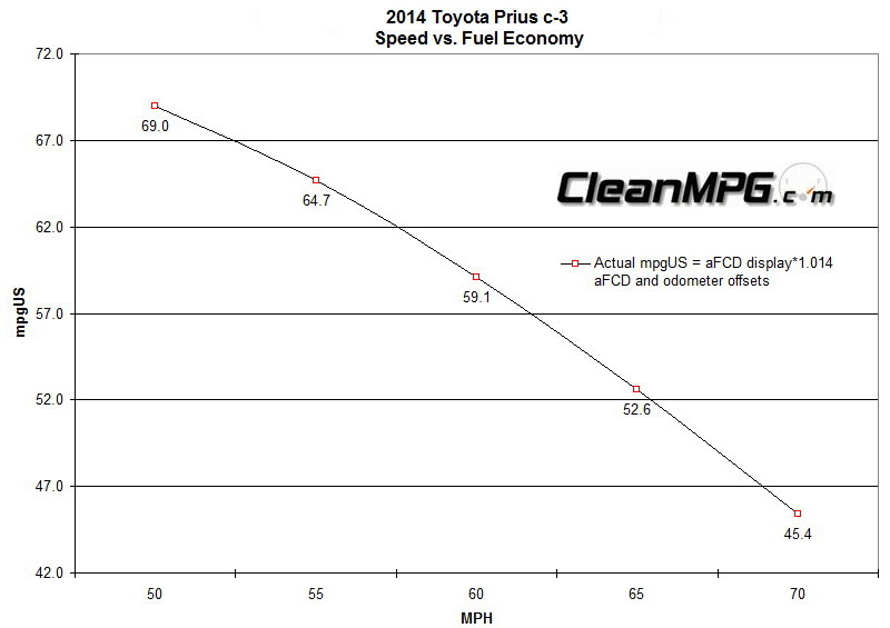

  9. priusCpilot
    priusCpilot Active Member
    Mar 6, 2012
    631
    209
    LA
    Steady state speed for both cars. 2014_Toyota_Prius_5_-_Speed_vs_FE.jpg 2014_Toyota_Prius_c_Speed_vs_FE.jpg
  10. ztanos
    ztanos All-around Geek!
    Jan 10, 2013
    3,339
    1,150
    Cumming, Georgia
    So this is saying that the PC is more efficient at 70 mph?
  11. priusCpilot
    Mar 6, 2012
    631
    209
    LA
    Yes but the 3rd Gen tested was with the factory 17" wheels.
    ztanos likes this.
