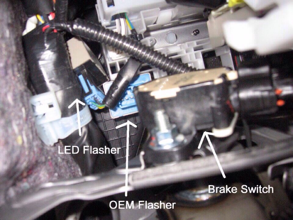

    Push your seat all the way back and get comfortable lying on your back with your head as close to the brake pedal as you can get. Look straight up. You'll barely be able to see the relay, and it may help you to snap some pictures to orient yourself. You're looking for this (best picture of it on PC so far):

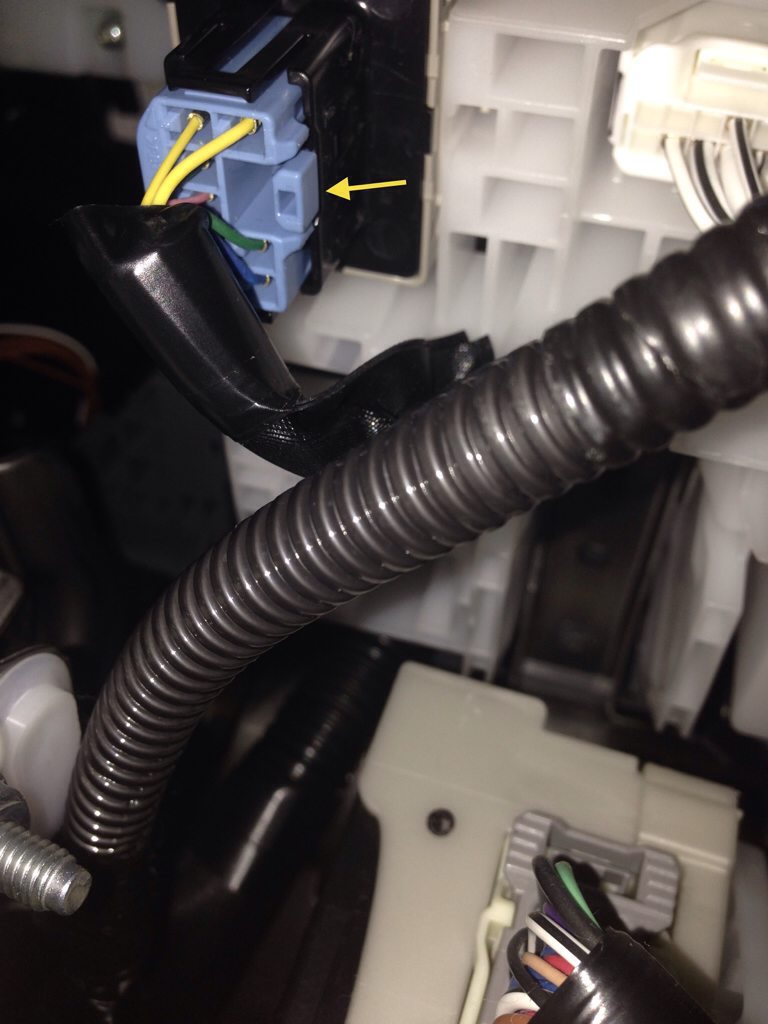

    Once you find it, the rest is done with your right hand by feel only. Feel for the tab indicated by the arrow. You'll easily be able to press the tab with your index finger. Next, grab the harness with your thumb and index finger and push UP, then squeeze the tab hard, and only then do you pull down. Do not force it. If it doesn't come out easily, try again.
    Once it's out, you'll plug in your relay single-handed (again by feel - and it can only go in one way, don't force, you'll hear or feel a click once in) and you can either tuck it in or zip-tie it securely. The space up there is pretty small so tucking it in will keep it fairly secure. Zip-tying is just extra work.

    Finished work should look like this (without zip-tie):
