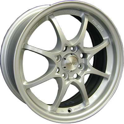

    With the info gathered from my test fit, I up and ordered some wheels for the c today. They weigh 12lbs per wheel and I'll be using the stock tires for now which weigh 17lbs making the total weight 29lbs per wheel/tire set. The stock wheel and tires weigh 32.5, so I should be saving 3.5 lbs per wheel/tire or a 14lb savings overall. Those that know tires and wheels should know that a savings of 14lbs in unsprung weight is huge. :)
    ordered these...
    Mazda Performance Parts: Konig Helium 15x6.5 Silver 40mm offset.
    filipinoof07 and F8L like this.

  16. kkim
    kkim Active Member
    Jan 27, 2007
    385
    127
    kauai, hawaii
    yep, I was looking at lighter wheels, but could not justify paying at least twice as much per wheel for 2 or 3 lbs less weight.
    the other wheel I was considering was the Konig lightspeed, but the wife preferred the look of the heliums. It's her car, so we're getting what appeals to her.
    Mazda Performance Parts: NEW Konig LIGHTSPEED 15x6.5, 38mm, just 11.0 pounds! ON SALE!

  20. kkim
    kkim Active Member
    Jan 27, 2007
    385
    127
    kauai, hawaii
    either should work. 2mm isn't that significant a difference. If it concerns you, I'd err on the side of 40mm, which I did.
    from what I've found, the stock steel wheels are 40mm offset, but don't forget as width increases, "correct" offset changes. that I put a 6.5" width 40et wheel on the car and experinced no rubbing says that the 40mm should work. wife has been driving the car with the wheels on and has had no problems.
