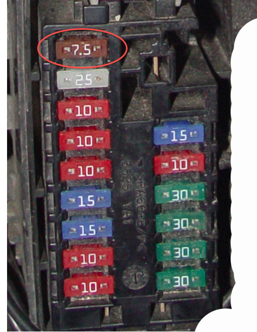

    We have had this problem intermittently now for 2 months. We have been to two dealers, neither of whom know how to fix this problem. The last one we even had the car towed to the dealer while the error was live on the MFD so they would be able to see it with the error happening (the last dealer had told us that they could see in the system that the error had happened, but they couldn't diagnose it unless it was actually happening at the time). Instead of pulling it into the garage and plugging it into their computer, a tech restarted it out in the lot and drove it in. This of course, reset the system and they couldn't track the error. They had it for two days and "were unable to replicate the issue".
    What confuses me is that these dealerships seem to have NO communication system. I find it hard to believe that NO ONE has seen this problem (both dealers we went to said they had never seen it before). Surely some dealer, somewhere, has a fix for this. I'm a computer tech and I belong to listserve where I can post questions on tech issues I'm struggling with. Usually someone has seen the problem and can tell me the fix. Are these guys each operating in a vacuum? HELLO, LET'S WORK TOGETHER, PEOPLE...
    We finally picked it up and drove it home. Later my wife got in it, started it up, and BINGO, it happened again. We are getting very frustrated with this. The first place we took it to did replace the 12V battery, but that did not fix the problem. Perhaps it's the inverter coolant pump, but we'll probably never know.
    All that being said, if this ever happens to you while you're on the road, there is a workaround that can get you rolling again so you're not stranded. I tried the fuse trick yesterday and it works perfectly: clears all the errors and you can restart the car normally.
    the tech said that if you pull the top left 7.5v fuse in the lower section of the fuse box, leave it out for 30 seconds or so, then replace it (see photo), this should reset the error system and allow you to start it and get it in drive. He also said that if that doesn't work you could try pulling the negative battery cable off for a few seconds and that should accomplish the same thing.
